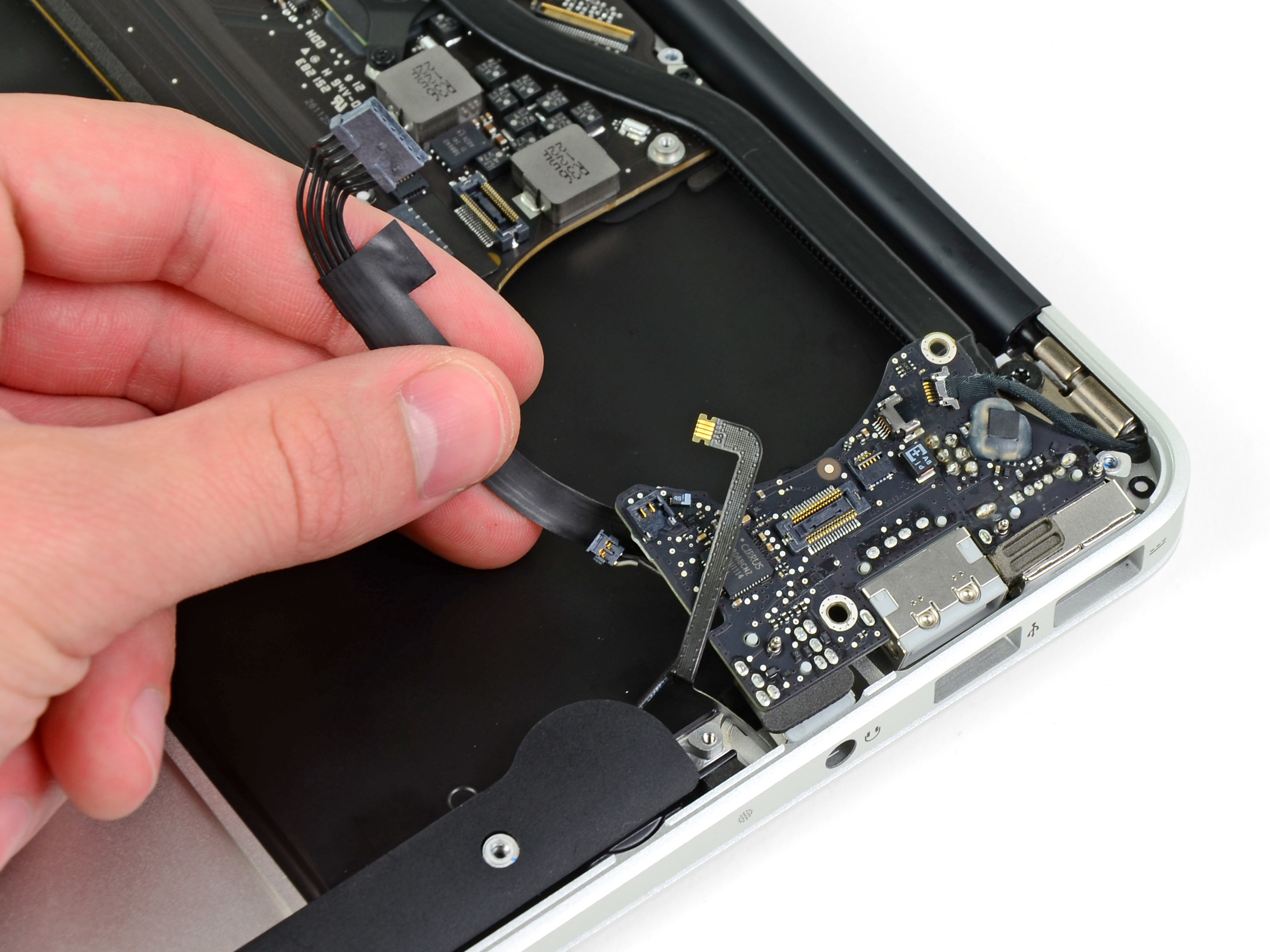

Add Note Edit Step 17  ¶
  • Pull the camera cable parallel to the face of the I/O board toward the rear edge of the Air to disconnect it from its socket.
  • Do not lift upward on this cable as you disconnect it, as its socket may break off the logic board.
Image #1
Add Note Edit Step 18  ¶
  • Remove the small rubber gasket from the corner of the upper case nearest the I/O board.
Image #1
Add Note Edit Step 19  ¶
  • Remove the single 3.6 mm T5 Torx screw securing the I/O board to the upper case.
Image #1
Add Note Edit Step 20  ¶
  • Carefully lift the I/O board from its edge nearest the logic board and remove it from the upper case.
