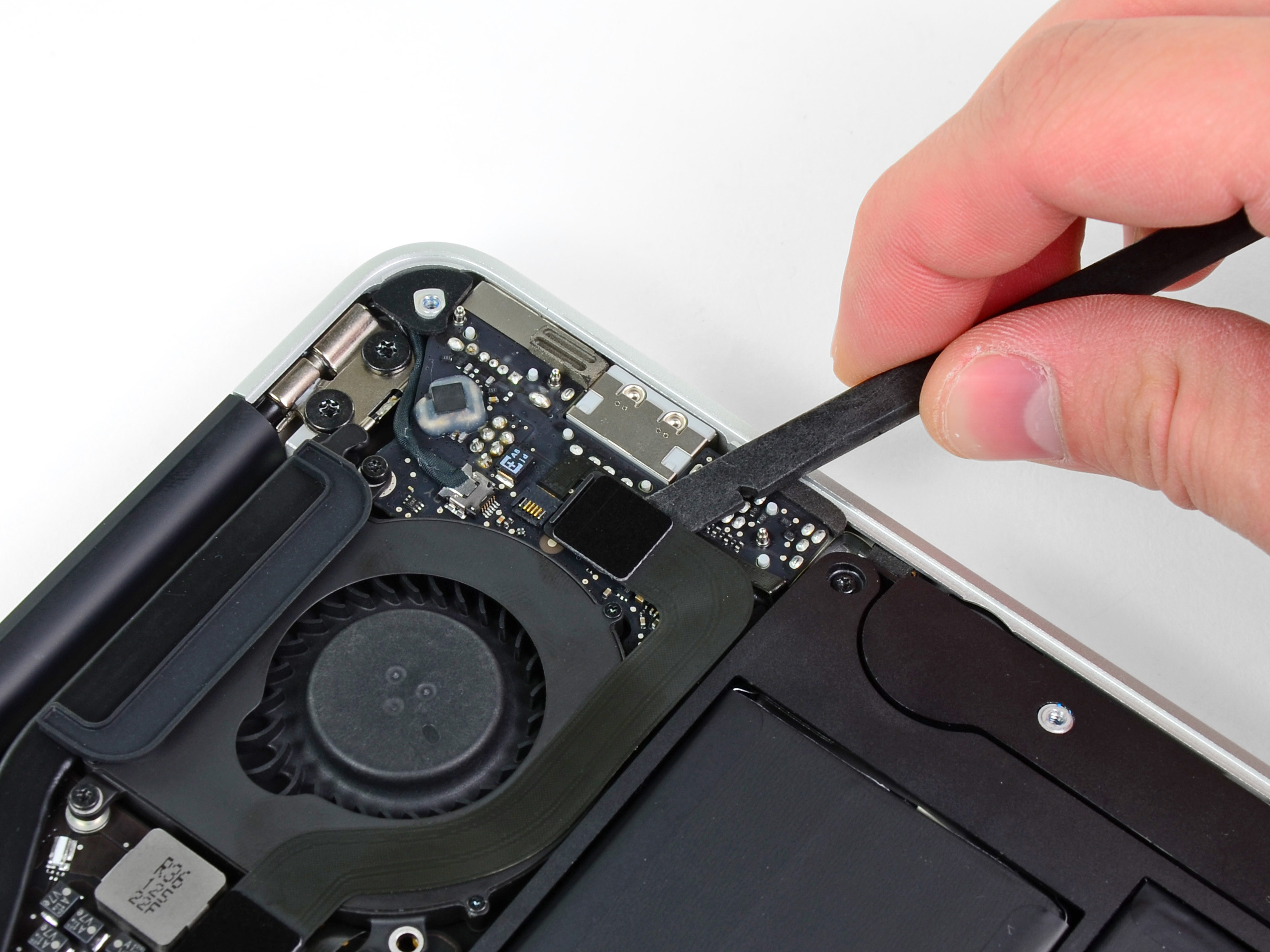

  3. MacBook Air 11" Mid 2011 I/O Board Cable Replacement, Battery: step 3, image 1 of 2 MacBook Air 11" Mid 2011 I/O Board Cable Replacement, Battery: step 3, image 2 of 2
    • In this step you will disconnect the battery to help avoid shorting out any components during service.
    • Use the flat end of a spudger to pry both short sides of the battery connector upward to disconnect it from its socket on the logic board.
    • Bend the battery cable slightly away from the logic board so the connector will not accidentally contact its socket.

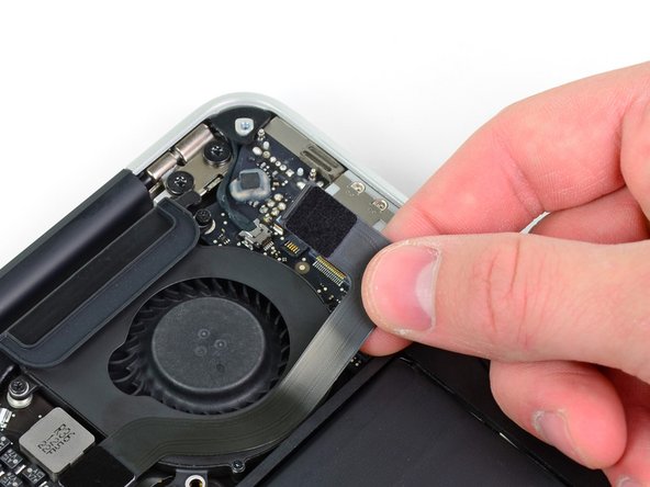

  4. MacBook Air 11" Mid 2011 I/O Board Cable Replacement, I/O Board Cable: step 4, image 1 of 2 MacBook Air 11" Mid 2011 I/O Board Cable Replacement, I/O Board Cable: step 4, image 2 of 2
    • Use the flat end of a spudger to pry the I/O board cable connector upward out of its socket on the I/O board.

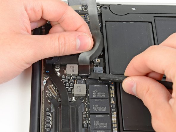

  5. MacBook Air 11" Mid 2011 I/O Board Cable Replacement: step 5, image 1 of 2 MacBook Air 11" Mid 2011 I/O Board Cable Replacement: step 5, image 2 of 2
    • The following connector has an especially deep socket. Use care when disconnecting it.

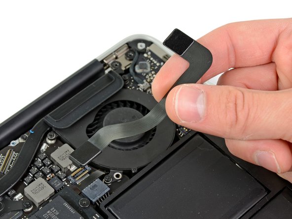

    • While gently pulling the I/O board cable upward near its connection to the logic board, use the tip of a spudger to pry upward on alternating sides of the connector to help "walk" it out of its socket.
    • Remove the I/O board cable.
