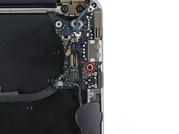

Add Note Edit Step 29  ¶
  • Remove the single 3.6 mm T5 Torx screw securing the I/O board to the upper case.
Image #1
Add Note Edit Step 30  ¶
  • Carefully lift the I/O board from its edge nearest the logic board and remove it from the upper case.

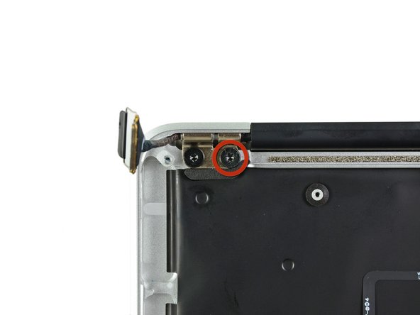

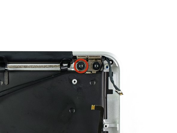

Image #1 Image #2
Add Note Edit Step 32  ¶
  • Remove the inner 4.9 mm T8 Torx screw securing each display hinge to the upper case (two screws total).
