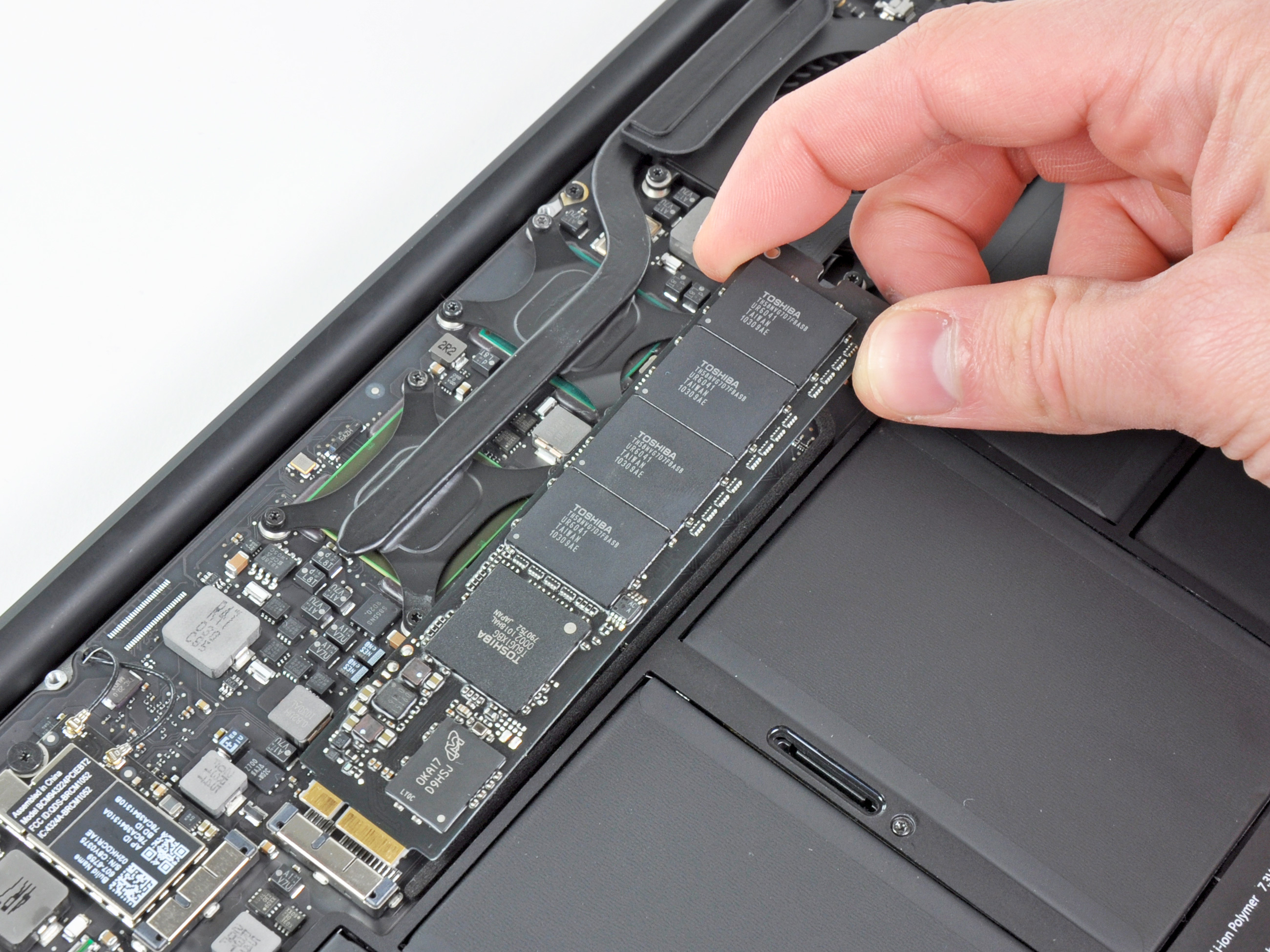

  4. MacBook Air 11" Late 2010 Solid-State Drive Replacement, Solid-State Drive: step 4, image 1 of 1
    • Remove the single 2.9 mm T5 Torx screw securing the SSD to the logic board.
  5. MacBook Air 11" Late 2010 Solid-State Drive Replacement: step 5, image 1 of 2 MacBook Air 11" Late 2010 Solid-State Drive Replacement: step 5, image 2 of 2
    • Use a spudger to help lift the free end of the SSD just enough to grab it with your other hand.
    • Do not lift the end of the SSD excessively.
    • Pull the drive straight out of its socket and remove it from the logic board.
    • When reinstalling the SSD, be sure it is properly seated before reinstalling its retaining screw.
