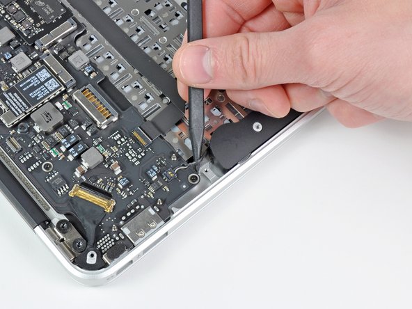

  • Use the tip of a spudger to de-route the right speaker cable from the channel cut into the logic board.
Image #1

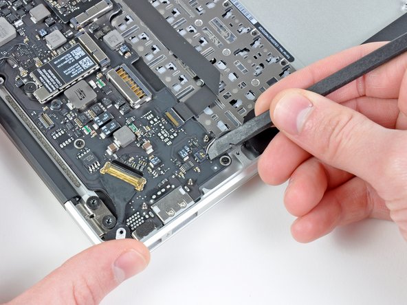

  • Use the flat end of a spudger to pry the right speaker cable connector up and out of its socket on the logic board.
  • Pry upward from beneath the wires.
Image #1 Image #2

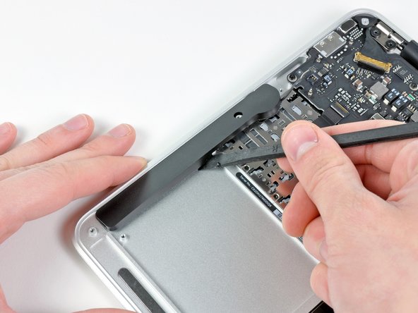

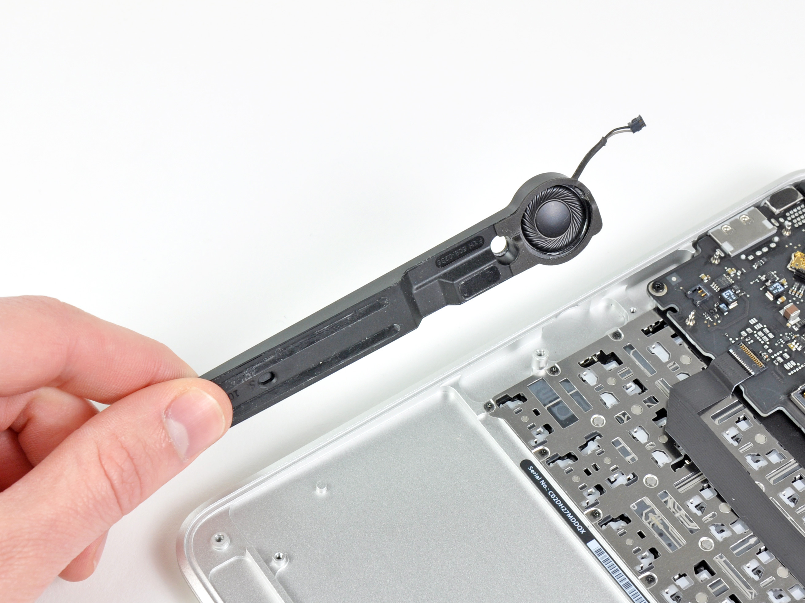

  • Use the flat end of a spudger to pry the right speaker off the adhesive securing it to the upper case.
  • Only pry up on the speaker from the areas of bare aluminum on the upper case. Prying up from the keyboard area may damage the keyboard and the speaker itself.
  • Remove the right speaker from the upper case.
