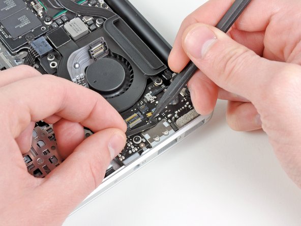

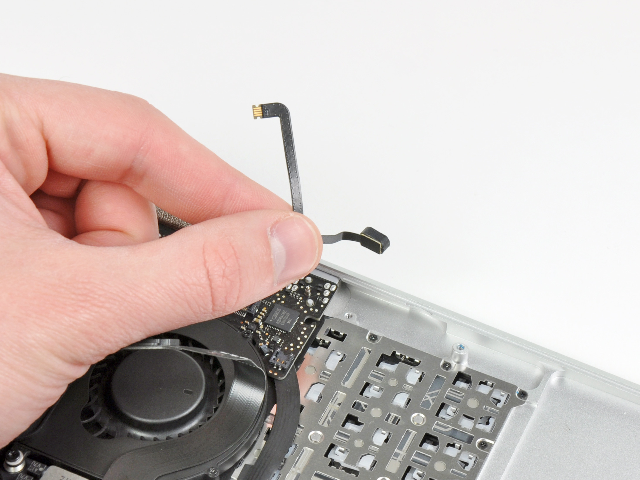

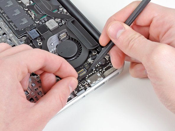

Add Note Edit Step 6 — Left Speaker  ¶
  • Use the flat end of a spudger to pry the I/O board cable connector upward out of its socket on the I/O board.
Image #1 Image #2 Image #3
Add Note Edit Step 7  ¶
  • Use the tip of a spudger to flip up the retaining flap on the microphone ribbon cable ZIF socket.
  • Pull the microphone ribbon cable straight out of its socket.
Image #1
Add Note Edit Step 8  ¶
  • Use the tip of a spudger to de-route the left speaker cable from the notch cut into the edge of the I/O board.
