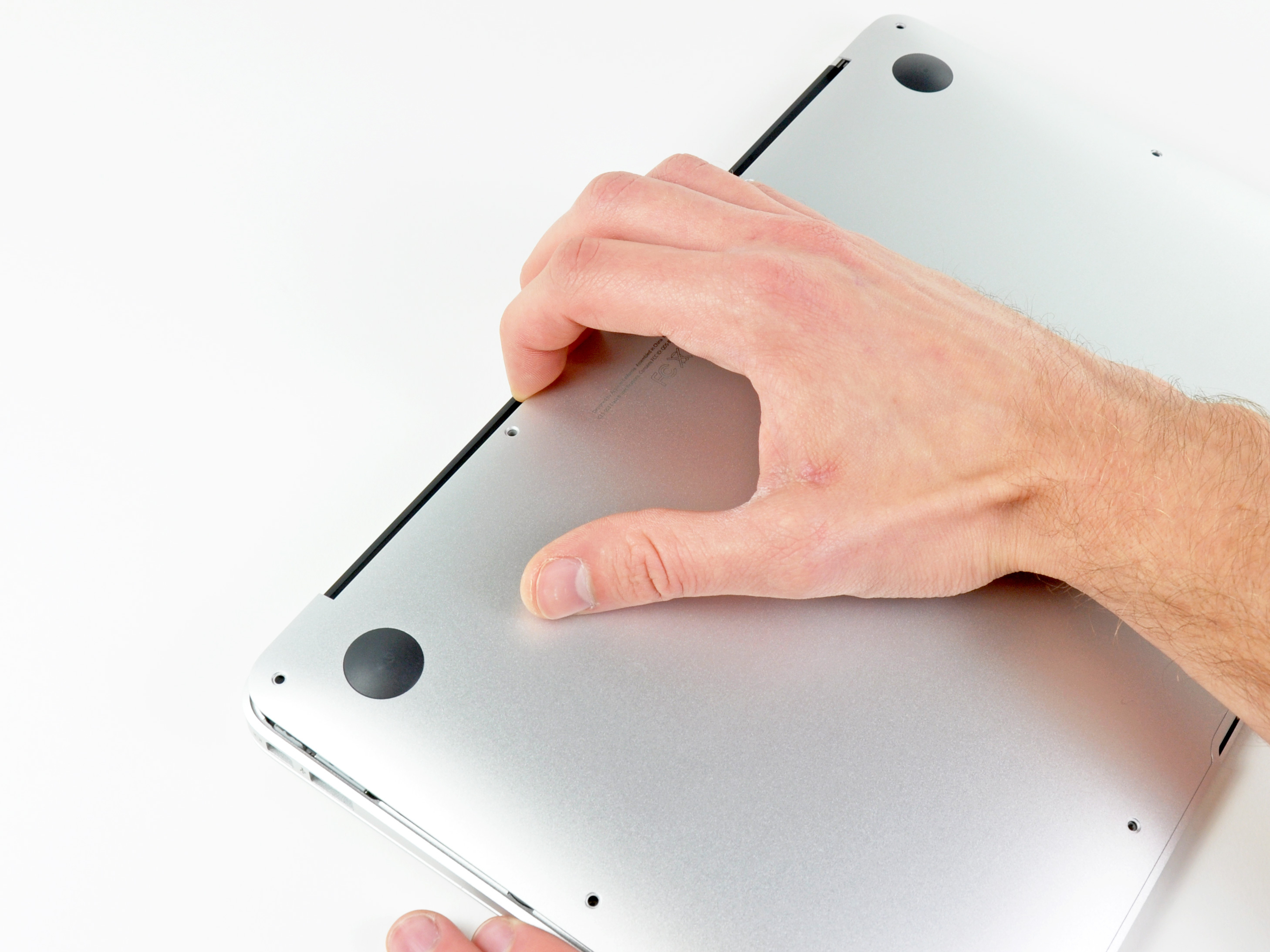

  • Before proceeding, close your computer and lay it on a soft surface top-side down.
  • Remove the following ten screws:
    • Two 8 mm 5-point Pentalobe screws
    • Eight 2.5 mm 5-point Pentalobe screws
  • The special screwdriver needed to remove the eight 5-point Pentalobe screws can be found here.
Image #1
Add Note Edit Step 2  ¶
  • Wedge your fingers between the display and the lower case and pull upward to pop the lower case off the Air.
