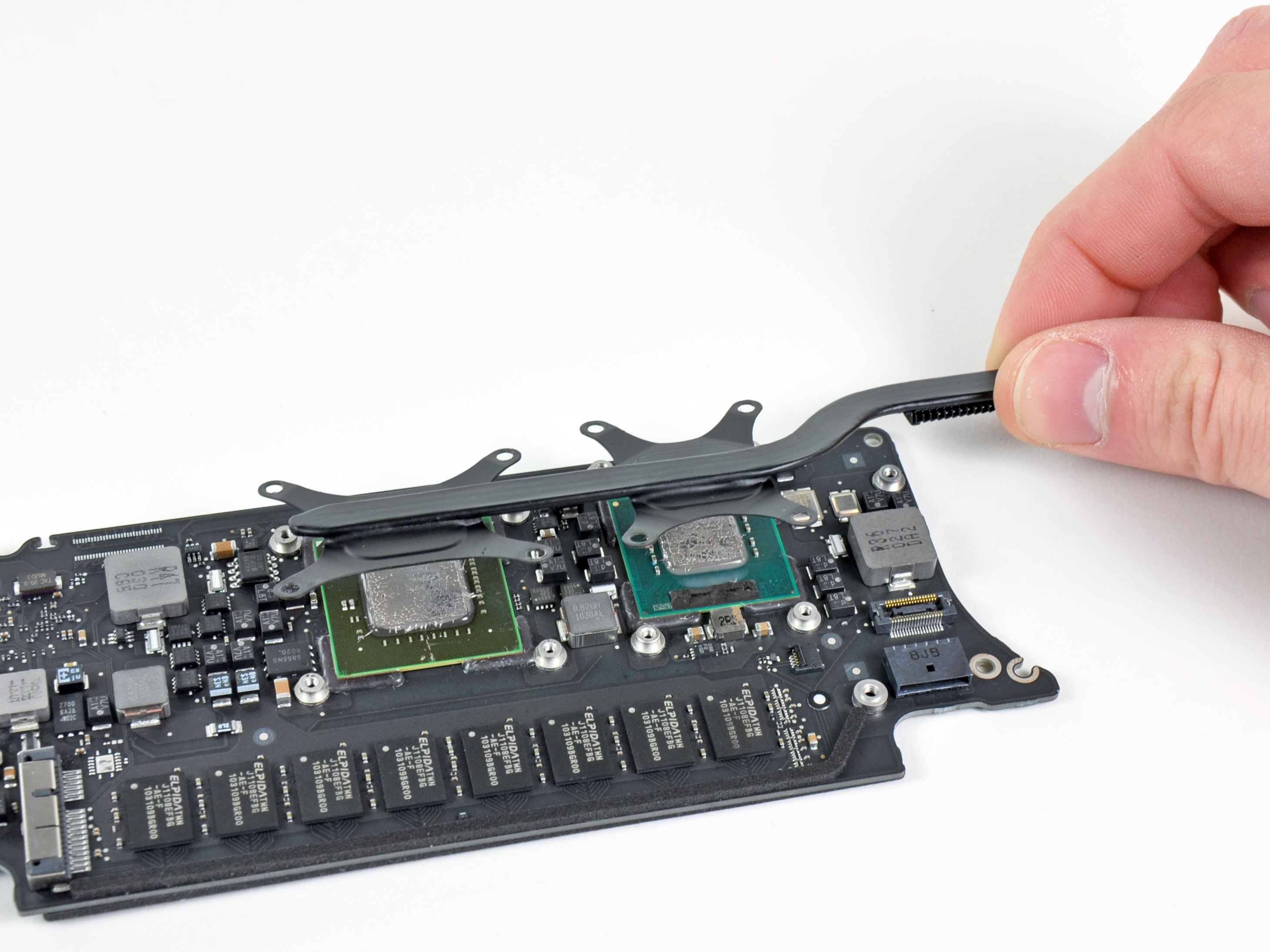

Use this guide to replace the bare logic board on your MacBook Air. Before reinstalling the heat sink, be sure to apply a new layer of thermal paste.

  • Wedge your fingers between the display and the lower case and pull upward to pop the lower case off the Air.
Image #1 Image #2
  • In this step you will disconnect the battery to help avoid shorting out any components during service.
  • Use the flat end of a spudger to pry both short sides of the battery connector upward to disconnect it from its socket on the logic board.
  • Bend the battery cable slightly away from the logic board so the connector will not accidentally contact its socket.
Image #1
Add Note Edit Step 4 — Solid-State Drive  ¶
  • Remove the single 2.9 mm T5 Torx screw securing the SSD to the logic board.
Image #1 Image #2
Add Note Edit Step 5  ¶
  • Use a spudger to help lift the free end of the SSD just enough to grab it with your other hand.
  • Do not lift the end of the SSD excessively.
  • Pull the drive straight out of its socket and remove it from the logic board.
  • When reinstalling the SSD, be sure it is properly seated before reinstalling its retaining screw.
Image #1
Add Note Edit Step 6 — I/O Board Cable  ¶
  • Use the flat end of a spudger to pry the I/O board cable connector upward out of its socket on the I/O board.
Image #1
Add Note Edit Step 7  ¶
  • The following connector has an especially deep socket. Use care when disconnecting it.
  • While gently pulling the I/O board cable upward near its connection to the logic board, use the tip of a spudger to pry upward on alternating sides of the connector to help "walk" it out of its socket.
  • Remove the I/O board cable.
Image #1
Add Note Edit Step 8 — Fan  ¶
  • Use the tip of a spudger to carefully flip up the retaining flap on the fan cable ZIF socket.
