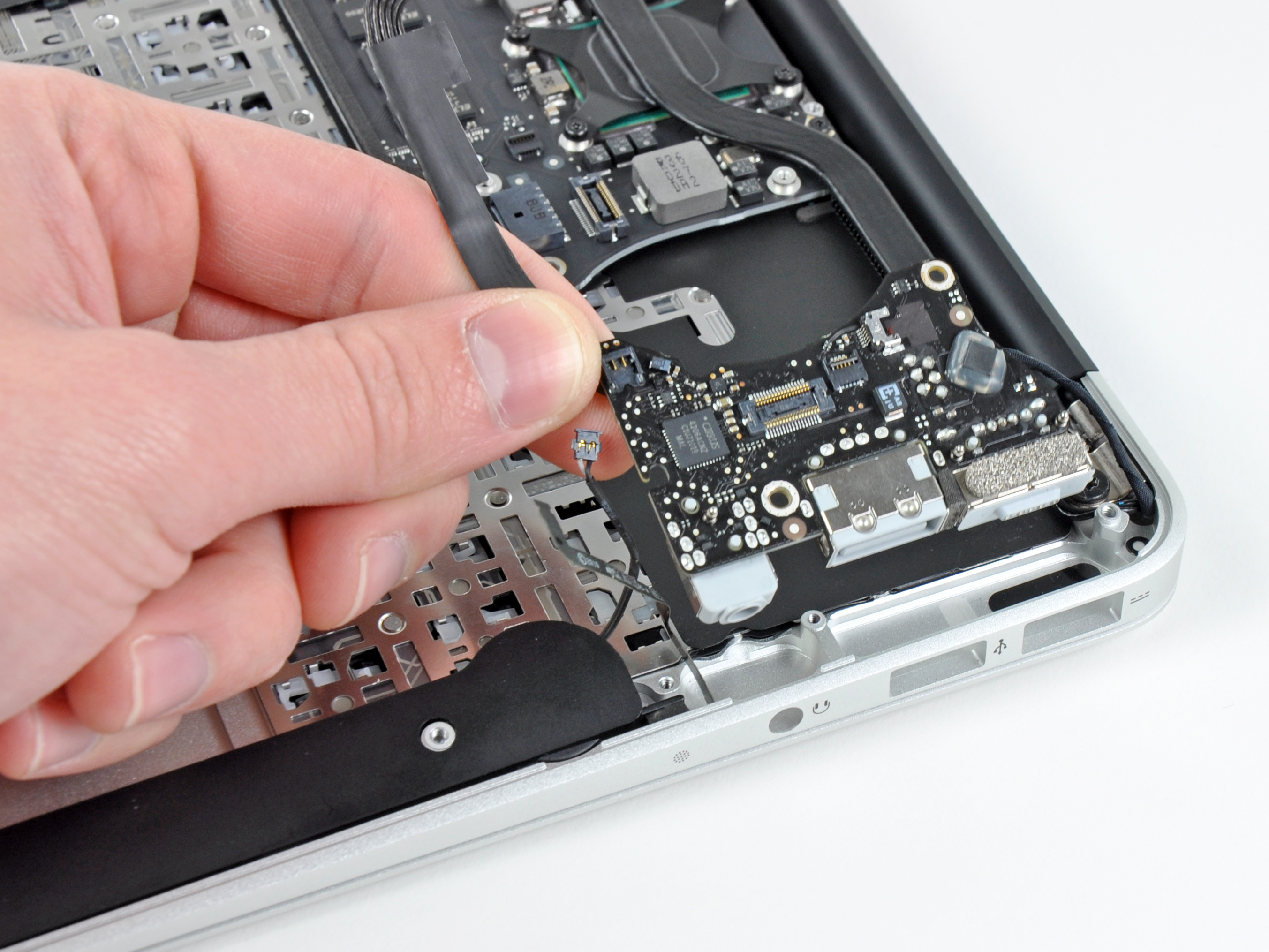

Add Note Edit Step 6 — I/O Board Cable  ¶
  • Use the flat end of a spudger to pry the I/O board cable connector upward out of its socket on the I/O board.
Image #1
Add Note Edit Step 7  ¶
  • The following connector has an especially deep socket. Use care when disconnecting it.
  • While gently pulling the I/O board cable upward near its connection to the logic board, use the tip of a spudger to pry upward on alternating sides of the connector to help "walk" it out of its socket.
  • Remove the I/O board cable.
Image #1
