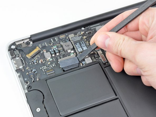

  • In this step you will disconnect the battery to help avoid shorting out any components during service.
  • Use the flat end of a spudger to pry both short sides of the battery connector upward to disconnect it from its socket on the logic board.
  • Bend the battery cable slightly away from the logic board so the connector will not accidentally contact its socket.

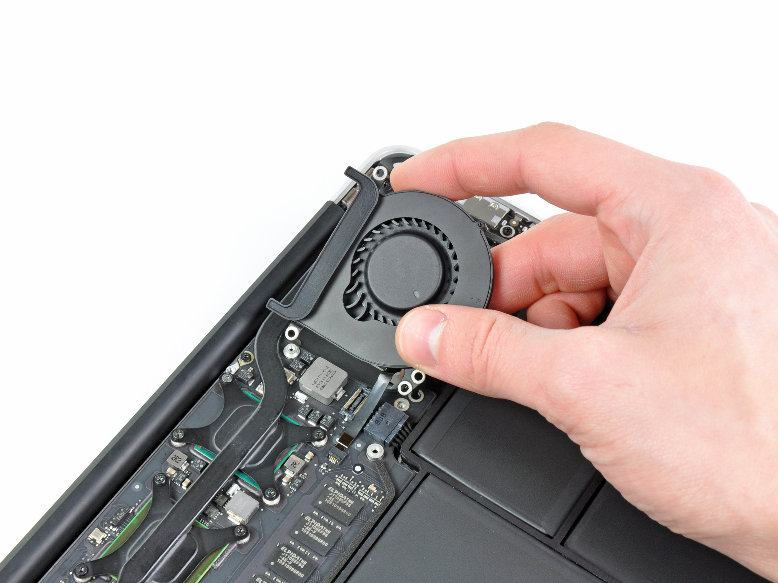

Add Note Edit Step 8 — Fan  ¶
  • Use the tip of a spudger to carefully flip up the retaining flap on the fan cable ZIF socket.
