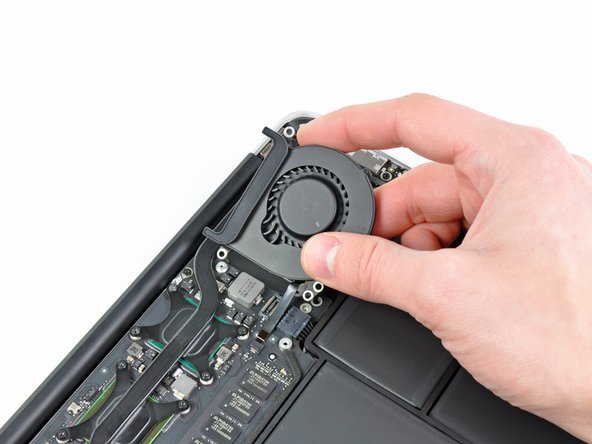

  • Remove the following three screws securing the fan to the upper case:
    • Two 5.2 mm T5 Torx screws
    • One 3.6 mm T5 Torx screw
Image #1
Add Note Edit Step 10  ¶
  • Lift the fan out of the upper case and carefully pull the fan ribbon cable out of its socket as you remove it from the Air.

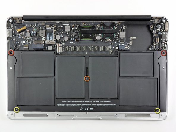

Add Note Edit Step 11 — Battery  ¶
  • Remove the following five screws securing the battery to the upper case:
    • One 6 mm T5 Torx screw
    • Two 2.6 mm T5 Torx screws

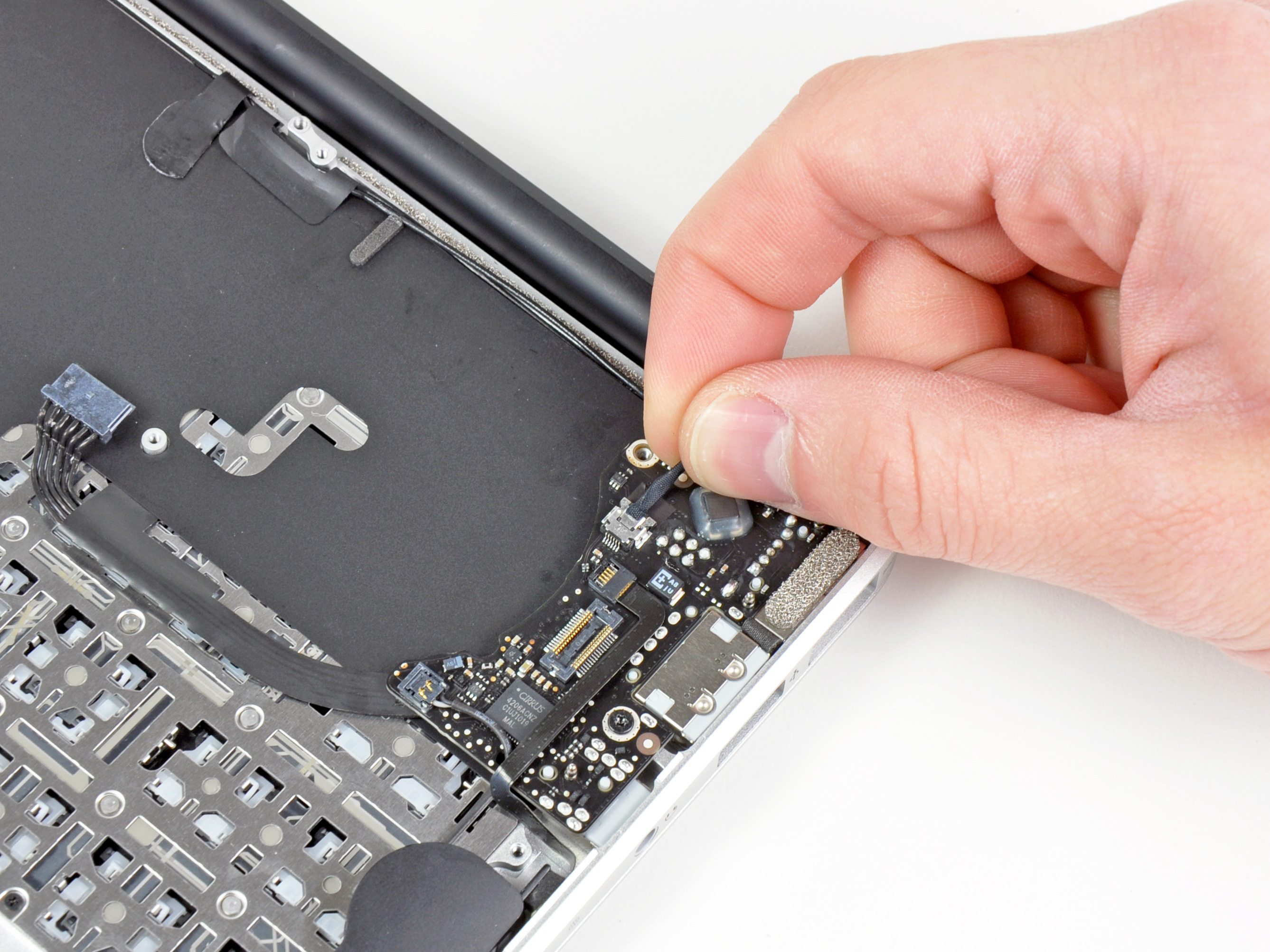

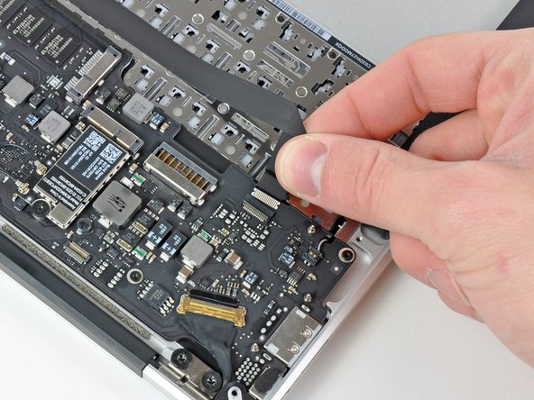

Add Note Edit Step 13 — Logic Board  ¶
  • Disconnect the I/O board by pulling the power cable away from its socket on the logic board.
  • Pull the cable parallel to the face of the logic board toward the front edge of the Air.

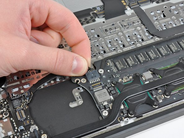

Image #1 Image #2
Add Note Edit Step 14  ¶
  • Use the tip of a spudger or your fingernail to flip up the retaining flap on the trackpad ribbon cable ZIF socket.
  • Pull the trackpad ribbon cable straight out of its socket toward the front edge of the Air.
Image #1

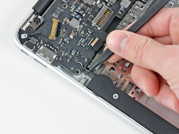

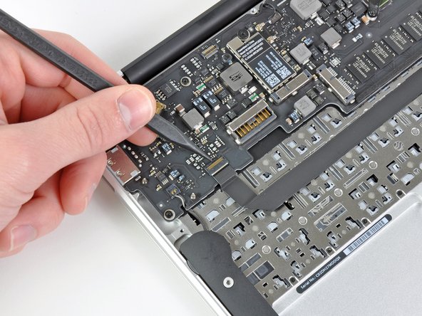

Add Note Edit Step 15  ¶
  • Use the tip of a spudger to de-route the right speaker cable from the slot cut into the logic board.
Image #1
Add Note Edit Step 16  ¶
  • Use the flat end of a spudger to pry the right speaker cable connector up and out of its socket on the logic board.
  • Pry up from beneath the cables.
