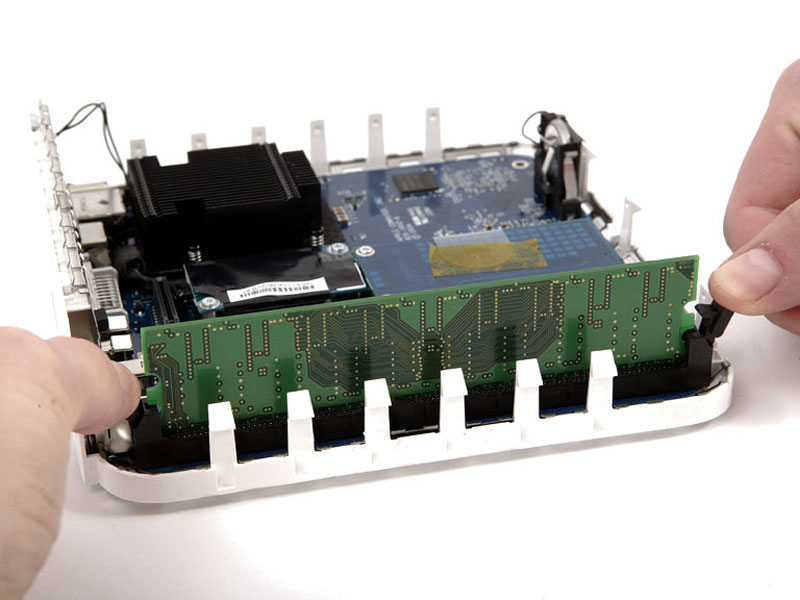

  12. Mac mini (PowerPC) RAM Replacement, RAM: step 12, image 1 of 1
    • Pull back the black plastic latches on either end of the RAM chip.
  13. Mac mini (PowerPC) RAM Replacement: step 13, image 1 of 1
    • Grasp the RAM chip at the end opposite of the back ports, and pull directly up.

Many thanks for giving me the confidence to do this, and the images make it soooo much easier.
My comment is that on my A1103 with Airport (but without the module above the RAM),I didn't even need to remove the HDD/CD assembly, thus cutting down upgrade time considerably. I was pleased to note that RAM replacement did not require the RAM module to be angled forward/backward as on some main boards,
Peter Garner - Reply
Agreed. I didn't need to remove the assembly either. The RAM comes straight up.
