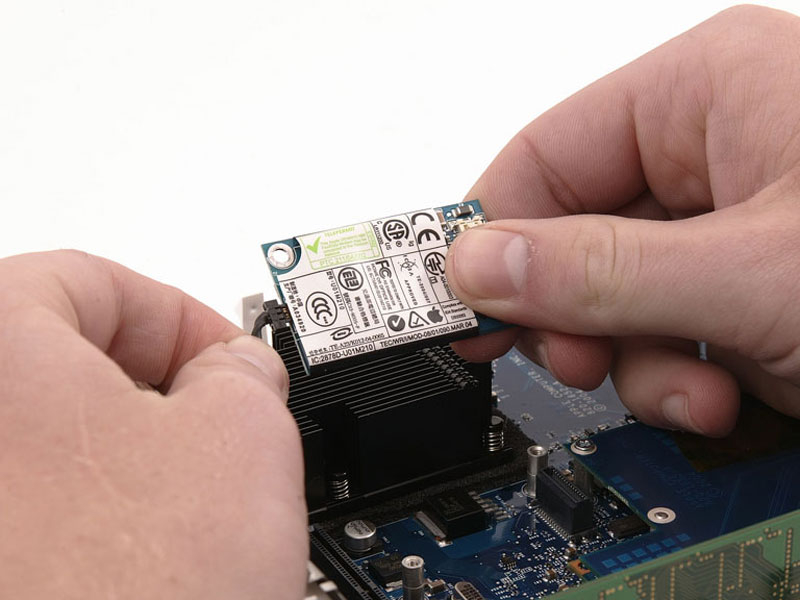

Add Note Edit Step 10 — Modem  ¶
  • Remove the two silver Phillips screws from the corners of the modem board.
first image
Add Note Edit Step 11  ¶
  • Pull the modem up from its connector. If it sticks, just wiggle it back and forth a bit as you pull up.
first image
Add Note Edit Step 12  ¶
  • Disconnect the RJ-11 cable from the back of the modem.
