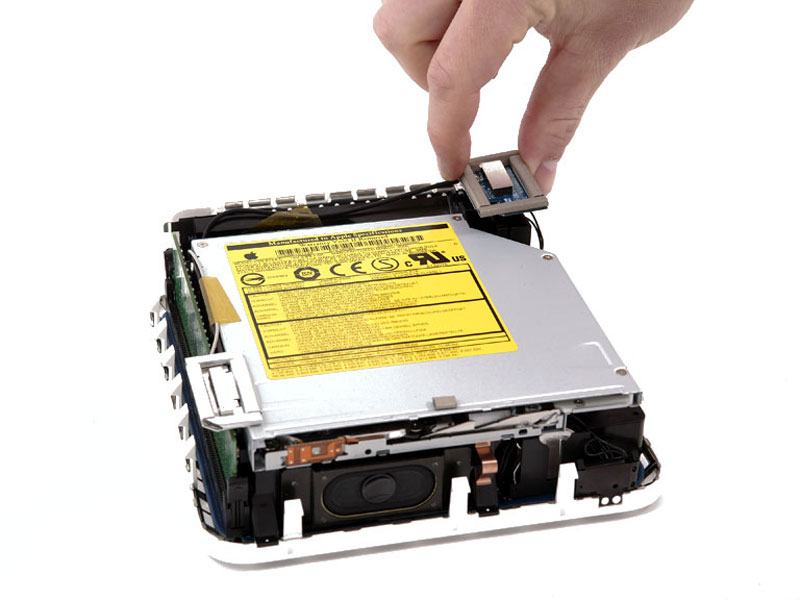

Add Note Edit Step 5 — Mass Storage Unit  ¶
  • If your mini does not have Airport installed, then skip this step.
  • Grasp the Airport antenna board and lift it off of the two plastic posts holding it in place. You may need to push back the black plastic tab jutting through the lower left corner of the board.
