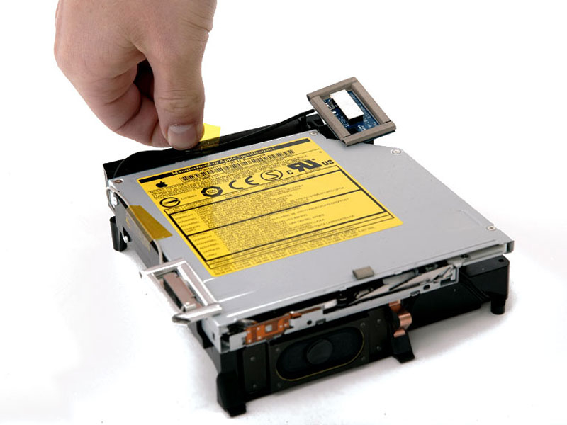

Add Note Edit Step 5 — Mass Storage Unit  ¶
  • If your mini does not have Airport installed, then skip this step.
  • Grasp the Airport antenna board and lift it off of the two plastic posts holding it in place. You may need to push back the black plastic tab jutting through the lower left corner of the board.
Image #1
Add Note Edit Step 6  ¶
  • Remove the yellow tape securing the power button cable to the black plastic framework.
Image #1
Add Note Edit Step 7  ¶
  • Remove the three black Phillips screws securing the plastic framework to the logic board and lower case.
Image #1
Add Note Edit Step 8  ¶
  • Grasp the optical drive and mass storage unit in one hand and lift up enough so that you can see beneath it.
