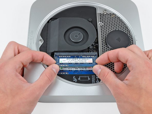

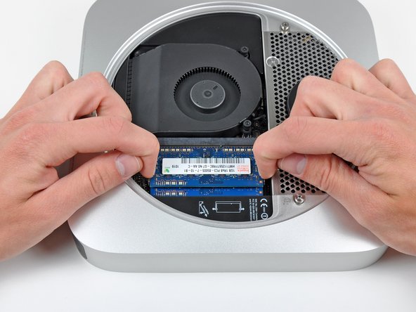

  3. Mac mini Mid 2010 RAM Replacement, RAM: step 3, image 1 of 2 Mac mini Mid 2010 RAM Replacement, RAM: step 3, image 2 of 2
    • Release the tabs on each side of the RAM chip by simultaneously pushing each tab away from the RAM.
    • These tabs lock the chip in place and releasing them will cause the chip to "pop" up.
    • After the RAM chip has popped up, pull it straight out of its socket.
    • Repeat this process if a second RAM chip is installed.

Do the RAM chips have to be paired, or could I replace a one gig bar with a 4 gig bar?
Thanks for any hints!
Hansen - Reply
They don't need to be paired, although that is the optimum. Just remember, it is best to make sure they are the same speed, or the Mac will just operate both RAMs at the speed of the slowest stick. For example, if you have 2x 1GB PC8500 sticks in there, and you replace one of them with a 4GB PC10600 stick (fastest speed this Mac Mini will run) you will get a benefit form the extra memory, but not the full speed upgrade as both RAMs will operate at the speed of the 8500 stick. Does that make sense? So replacing both with 2x 2GB PC10600 will give you better performance.
Mike Haines -
This Mac Mini will run PC10600 RAM sticks, although I believe only 4GB per slot.
Mike Haines -
This Mac can run 16GB of RAM, mine does. Just FYI.
Greg Martin - Reply
Interesting. I want to try that.
seaniepie -
