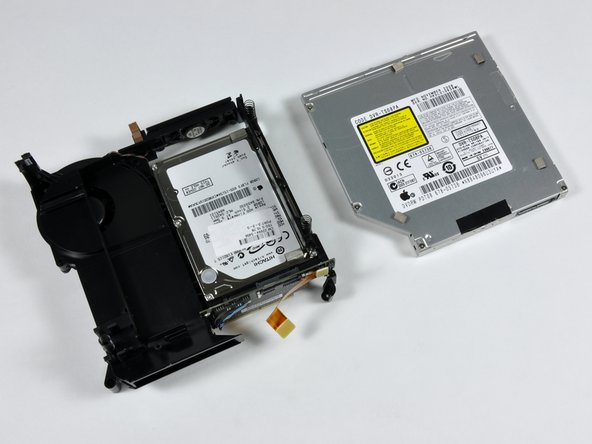

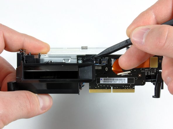

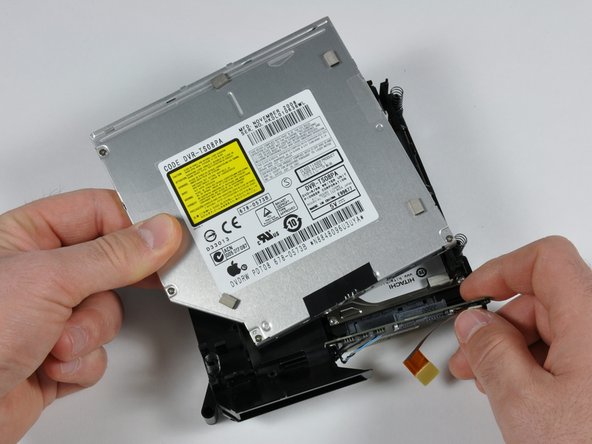

  • Use a spudger to remove the black tape securing the SuperDrive to the interconnect board.
  • Detach the interconnect board connector from the SuperDrive.
  • Lift the SuperDrive out of the internal frame.

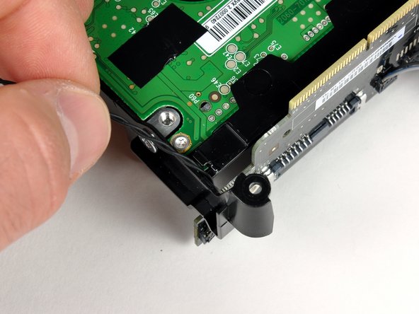

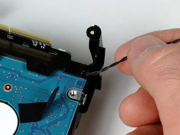

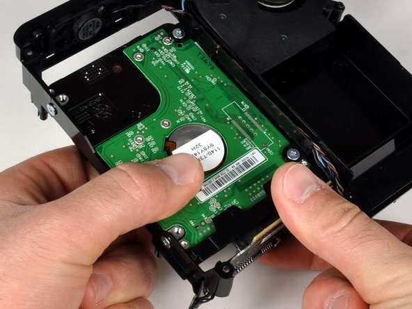

  • Flip the frame and then rotate it 180 degrees so that the speakers are facing you.
  • Be careful with this sequence of steps, as the thermal sensor (and its connector) are VERY frail.
  • Use a spudger to gently disconnect the thermal sensor from the hard drive.
  • Peel back the black tape and free the double-stranded wire from the drive.
  • Gently deroute the wire from the small notch on the frame (third picture).
  • Make sure that the thermal sensor remains connected to the interconnect board.

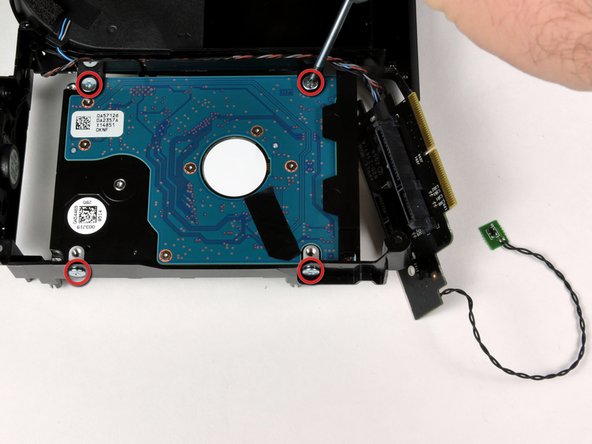

Add Note Edit Step 12  ¶

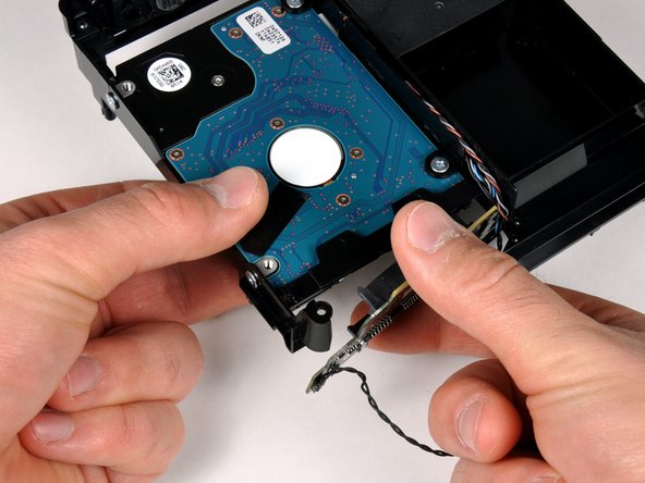

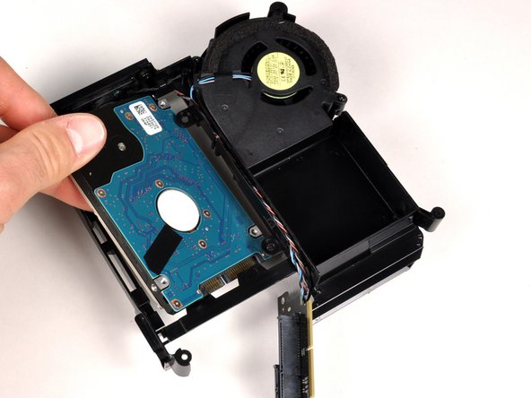

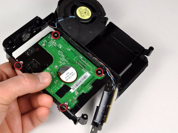

  • Unplug the interconnect board from the hard drive.
  • The interconnect board is still held in place by other connectors. Make sure that the they are not separated from the interconnect board.
  • Remove the four Phillips screws that hold the drive in place.
  • The stock hard drive can now be removed.

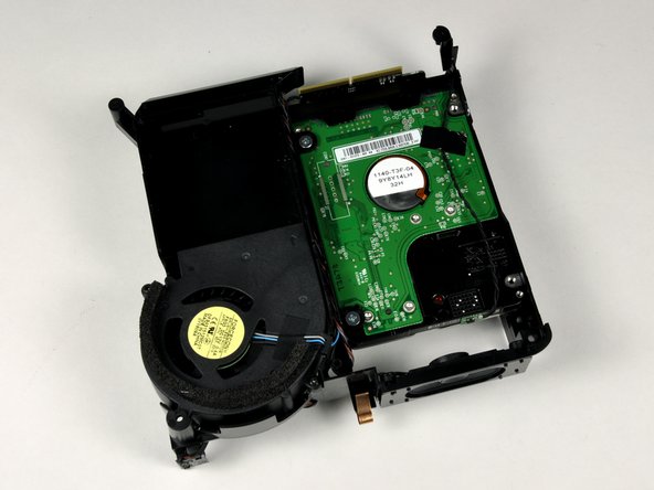

Add Note Edit Step 13  ¶
  • Hold the new drive in place and attach it to the frame using the four Phillips screws.
  • Plug the interconnect board into the new drive, making sure that all wires are in their original place.
  • Route the black thermal sensor wire back through the notch.

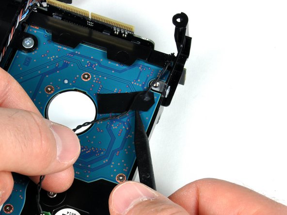

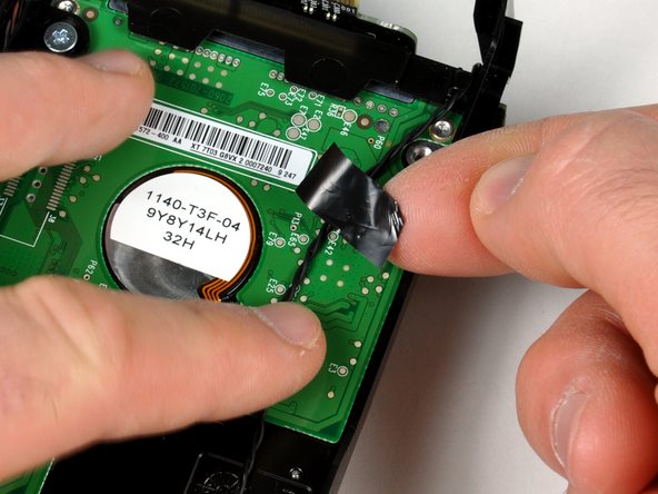

  • Secure the thermal sensor to the new hard drive. The original adhesive on the back of the thermal sensor should hold the sensor in place.
  • Reuse the black tape from the old drive to secure the thermal sensor wire to the new drive.
  • Your newly-installed drive should look very similar to the third picture.

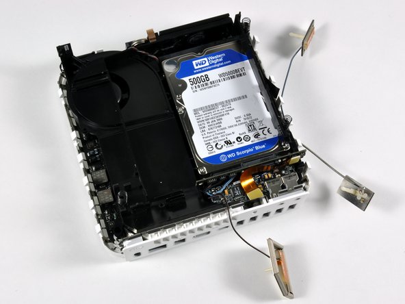

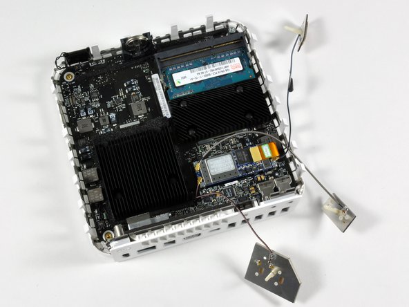

Add Note Edit Step 15  ¶

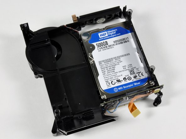

  • Flip over the internal framework with the newly attached drive. It should look like the first picture
  • Prepare the bottom housing for connection with the internal framework by connecting the antenna cables to the Broadcom AirPort card as shown
    • Arranging the antennas as pictured will ensure a smooth connection of the two large components
  • When setting the internal framework into the bottom housing, make sure the male connector on the interconnect board finds its way into the female connector on the logic board

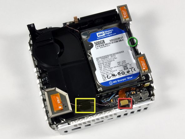

  • Snap the antenna boards back into their respective posts.
  • Tape the upper right antenna cable to the side of the internal framework (circled in green).
  • Route the bottom left antenna cable through the guides on the internal framework (marked in yellow).
  • Connect the orange ribbon cable from the interconnect board to the sound card (indicated in red).
