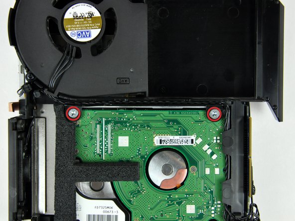

Add Note Edit Step 15 — Hard Drive  ¶
  • Remove the two Phillips screws securing the side of the hard drive to the internal frame.
Image #1
Add Note Edit Step 16  ¶
  • Remove the two Phillips screws securing the bottom of the hard drive to the internal frame.
