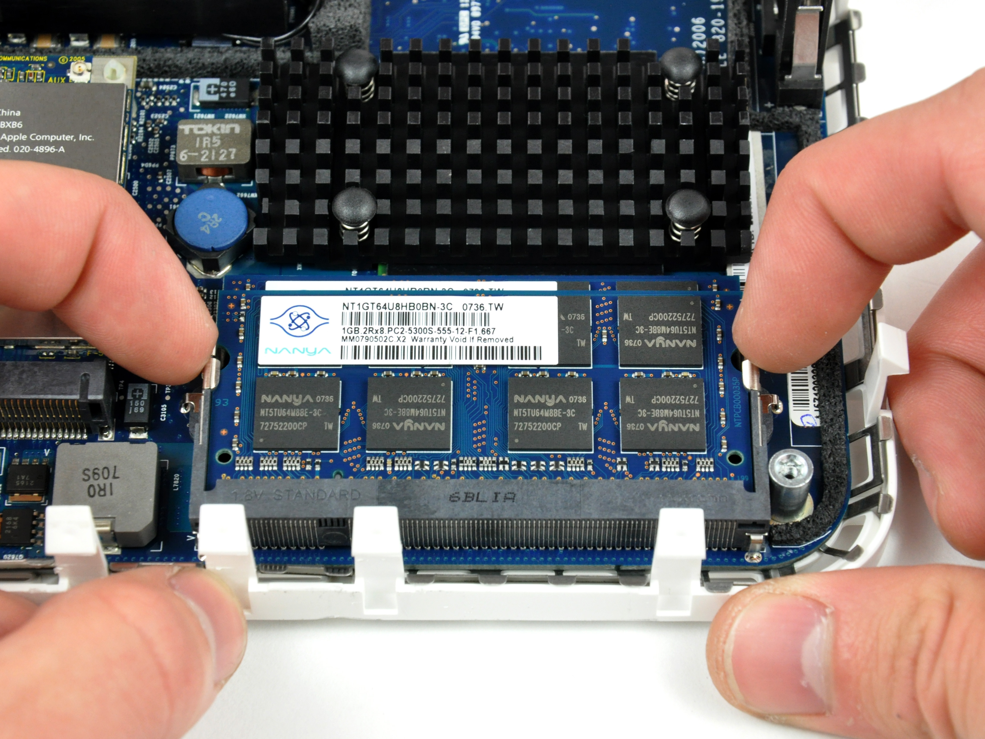

Installing Mac mini Model A1176 RAM
Featured Guide
This guide has been found to be exceptionally cool by the iFixit staff.
- Author: Walter Galan
- Difficulty: Moderate
Accessing the RAM requires the removal of the internal frame.
Relevant Parts
- PC2-5300 512 MB RAM Chip
- PC2-5300 1 GB RAM Chip
- PC2-5300 2 GB RAM Chip
(Core 2 Duo only, 3 GB RAM maximum)
