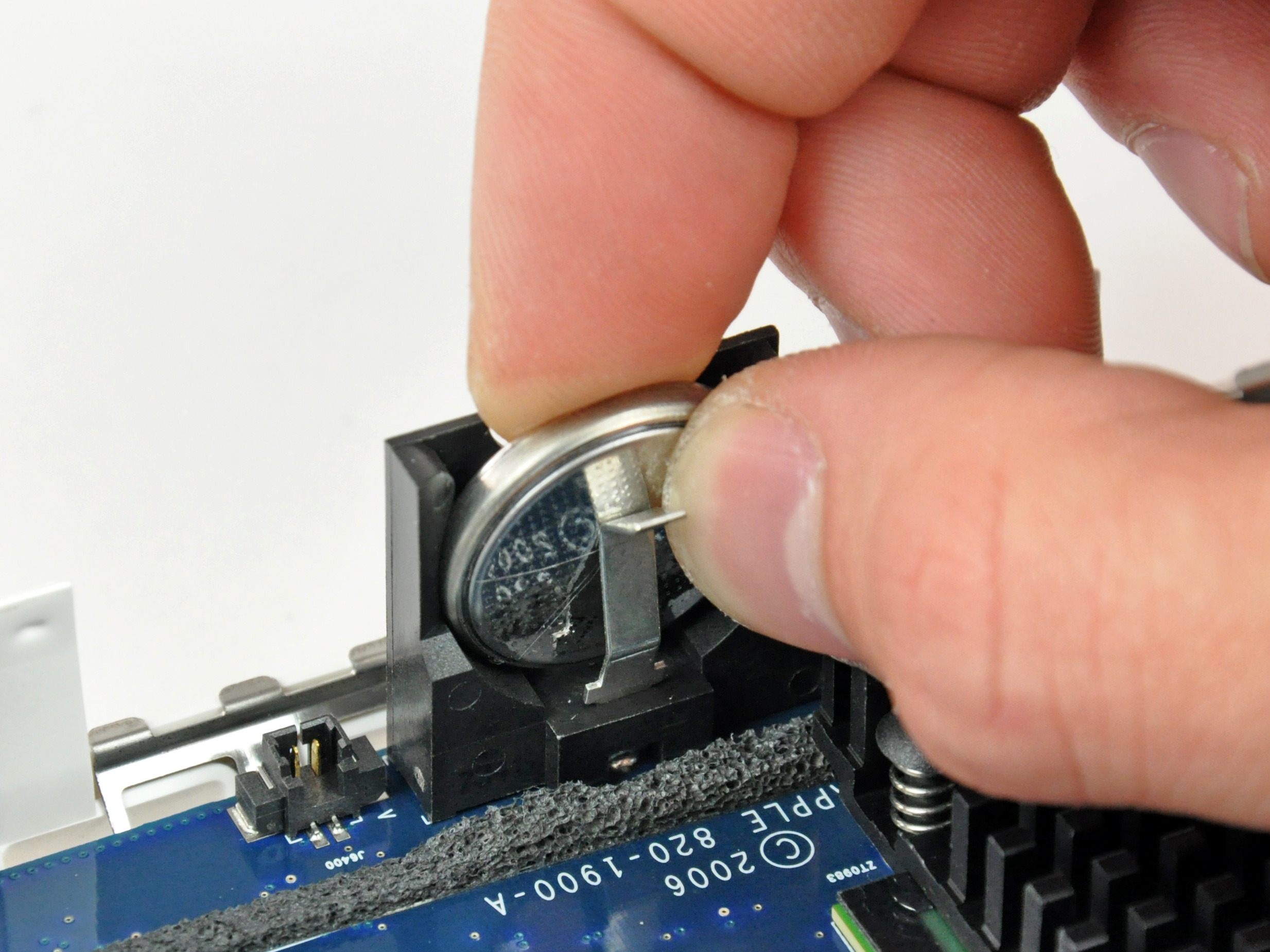

Installing Mac mini Model A1176 PRAM Battery
  • Add Note x
  • x 20
The time and date, as well as other settings, are kept by the PRAM battery when your machine is off.

Add Note Edit Step 1 — Top Housing  ¶
  • You can skip this step if you bought your putty knife from iFixit. Putty knives purchased from iFixit come with pre-ground edges.
  • You'll need a putty knife in order to open the case. A 1.5 inch thin putty knife will work well, but you'll want to grind the edge down. Rub the putty knife's short edge back and forth on a sheet of all purpose rough grit sandpaper (100 grit will work fine) until it attains a beveled edge.
Image #1 Image #2 Image #3
Add Note Edit Step 2  ¶
  • Carefully insert a putty knife into the crevice in between the top cover and bottom housing. Start on the left side first. Push the blade down until you meet firm resistance (roughly 3/8 of an inch).
  • Gently enlarge the existing crevice by prying the handle of the putty knife downward and away from the mini.
  • It helps to start in the middle, then work along the edge until the bottom housing pops up slightly.
Image #1
Add Note Edit Step 3  ¶
  • Next insert the putty knife into the crevice on the optical drive slot side of the computer.
  • Pry the putty knife downward while working along the edge of the mini until the bottom housing further separates from the top housing.
Image #1
Add Note Edit Step 4  ¶
  • Repeat the same procedure as the past few steps for the right side of the mini.
  • At this point, there should be a noticeable gap between the bottom and top housing around the perimeter of the mini.
  • Turn the mini over.
Image #1
Add Note Edit Step 5  ¶
  • Gently lift the top housing straight up off the mini and set it aside.
  • It may be necessary to wiggle the top housing while lifting it off the bottom housing. If any of the tabs get stuck on the top housing, use the putty knife to free them.
Add Note Edit Step 6 — Internal Frame  ¶
  • Later in this guide you will remove several recessed Phillips screws. Bit drivers are generally too large to fit in the recesses, so be sure to have a thin shafted Phillips screwdriver on hand.
  • First remove the AirPort antenna (the larger of the two), located near the power button.
  • Slightly squeeze the two retaining arms toward each other and lift the AirPort antenna off its post.
  • Squeezing the two posts excessively will surely break them off the internal frame. Work delicately.
  • During reinstallation, you will have to slightly squeeze the two posts together so they fit into the openings on the AirPort antenna board.
Image #1 Image #2
Add Note Edit Step 7  ¶
  • Use the tip of a spudger to slightly lift the left side of the ZIF cable lock up from its socket.
  • The ZIF cable lock will lift about 1 mm and stop. Do not try to completely remove the ZIF cable lock.
Image #1
Add Note Edit Step 8  ¶
  • Lift the audio board ribbon cable up out of its socket.
  • If it refuses to lift from its socket, the ZIF cable lock is not fully released. Make sure it is evenly lifted about 1 mm from the socket on the interconnect board.
