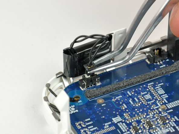

Add Note Edit Step 9  ¶
  • Rotate the mini so that the SuperDrive slot loading mechanism is facing you.
  • Use a pair of tweezers to lift the hard drive thermal sensor cable connector up off its socket on the logic board.
  • Use tweezers to grab the connector (as seen in the picture), not the wires.
  • The connector is located under the optical drive opening, next to the PRAM battery.
