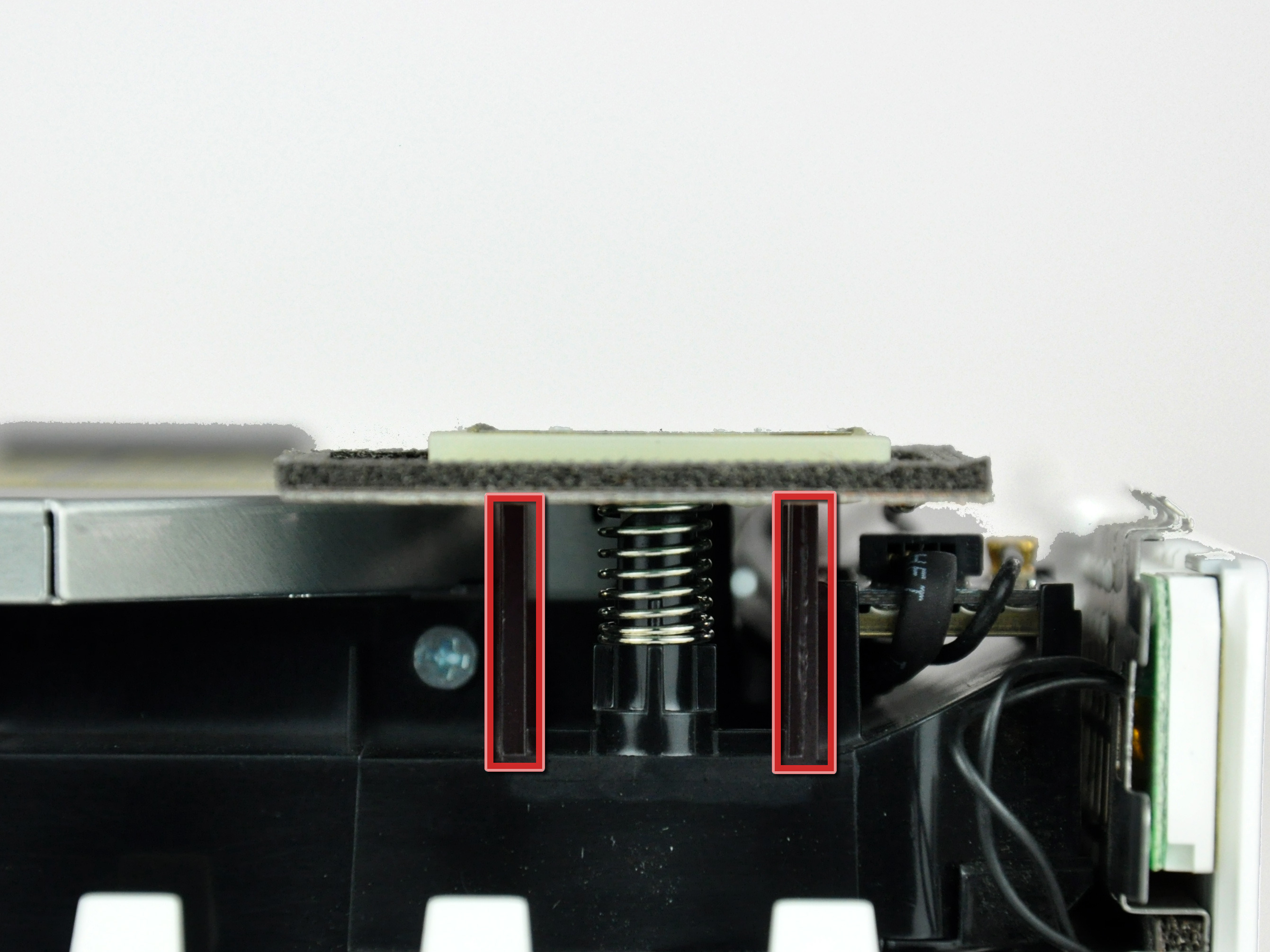

Add Note Edit Step 6 — Bluetooth Antenna  ¶
  • First remove the AirPort antenna (the larger of the two), located near the power button.
  • Slightly squeeze the two retaining arms toward each other and lift the AirPort antenna off its post.
  • Squeezing the two posts excessively will surely break them off the internal frame. Work delicately.
  • During reinstallation, you will have to slightly squeeze the two posts together so they fit into the openings on the AirPort antenna board.
Image #1
Add Note Edit Step 7  ¶
  • Remove the single Phillips screw securing the Bluetooth board to the internal frame.
Image #1
Add Note Edit Step 8  ¶
  • Lift the Bluetooth board off the internal frame and use the flat end of a spudger to pry the Bluetooth antenna cable connector up off the Bluetooth board.
