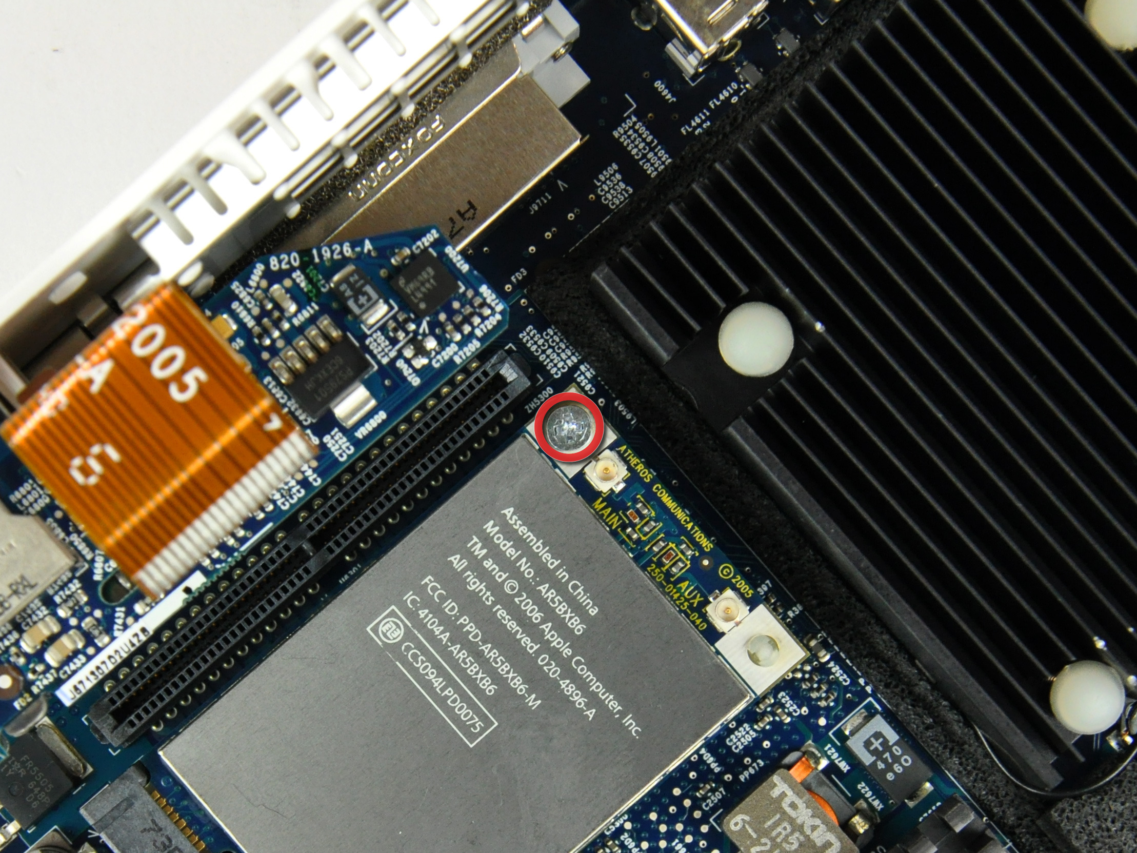

Add Note Edit Step 16 — AirPort Extreme  ¶
  • Remove the single Phillips screw securing the AirPort card to the logic board.
  • After removing this screw, the free end of the AirPort card should pop up slightly.
first image
Add Note Edit Step 17  ¶
  • Lift the AirPort card up slightly and pull it away from its socket on the logic board.
