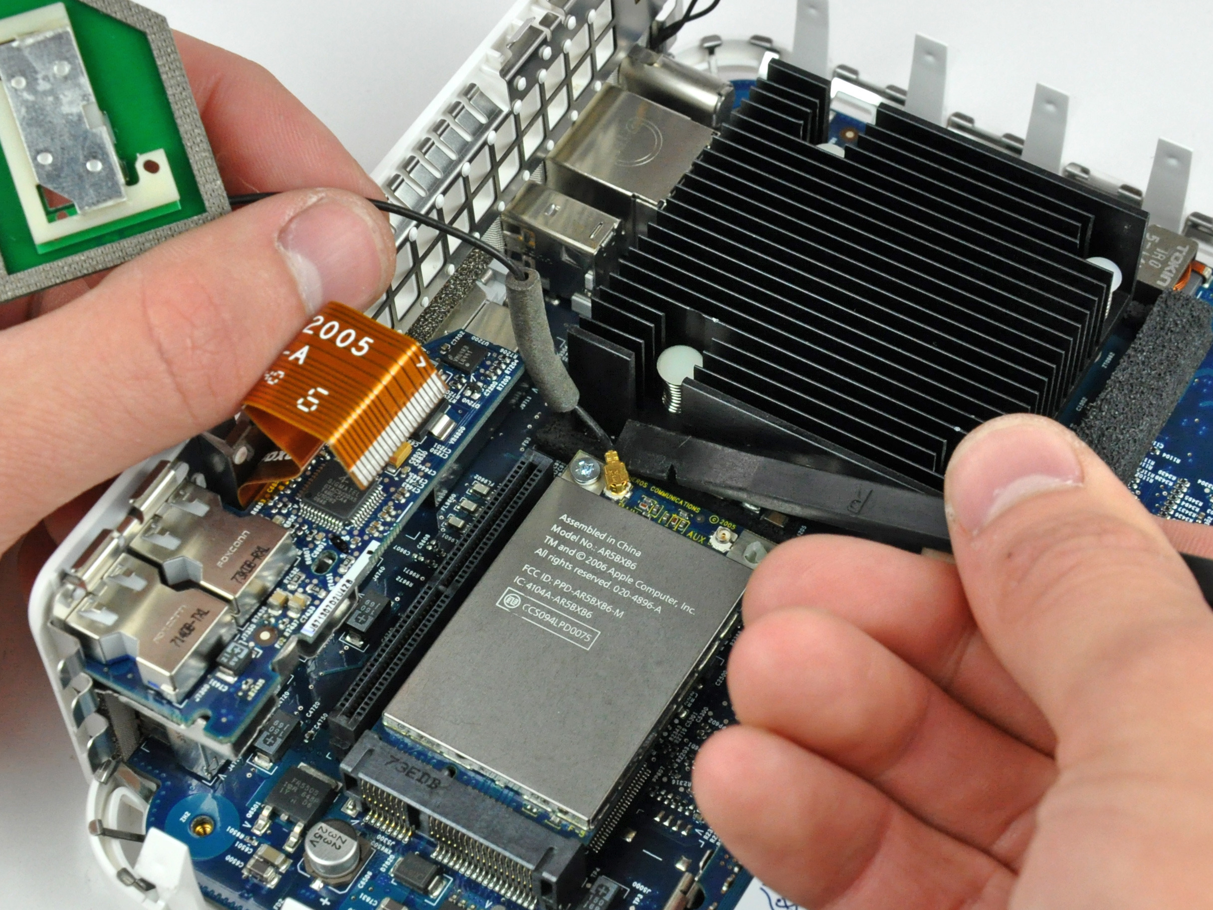

Add Note Edit Step 15 — AirPort Antenna  ¶
  • Use the flat end of a spudger to pry the AirPort antenna cable connector up off the AirPort card.
For more information, check out the Mac mini Model A1176 device page.
