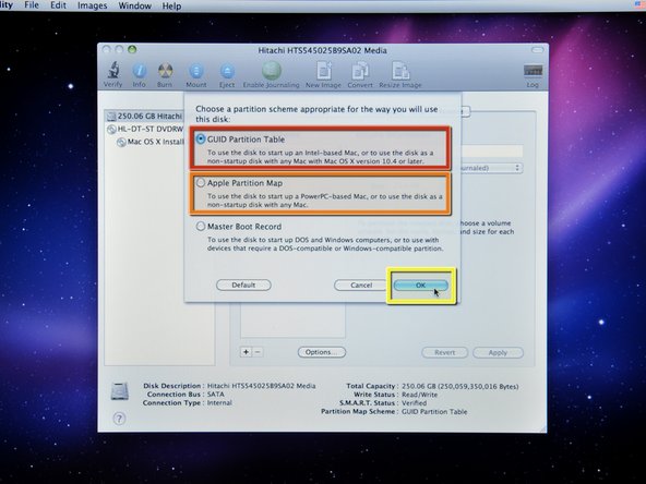

Image #1 Image #2 Image #3
Add Note Edit Step 23  ¶
  • Select the partition scheme required for your machine:
    • Select "GUID Partition Table" for Intel-based machines.
    • Select "Apple Partition Map" for PowerPC-based machines.
  • Click "Ok."
  • Press the "+" button to add a new partition.
  • Press the "Apply" button.
