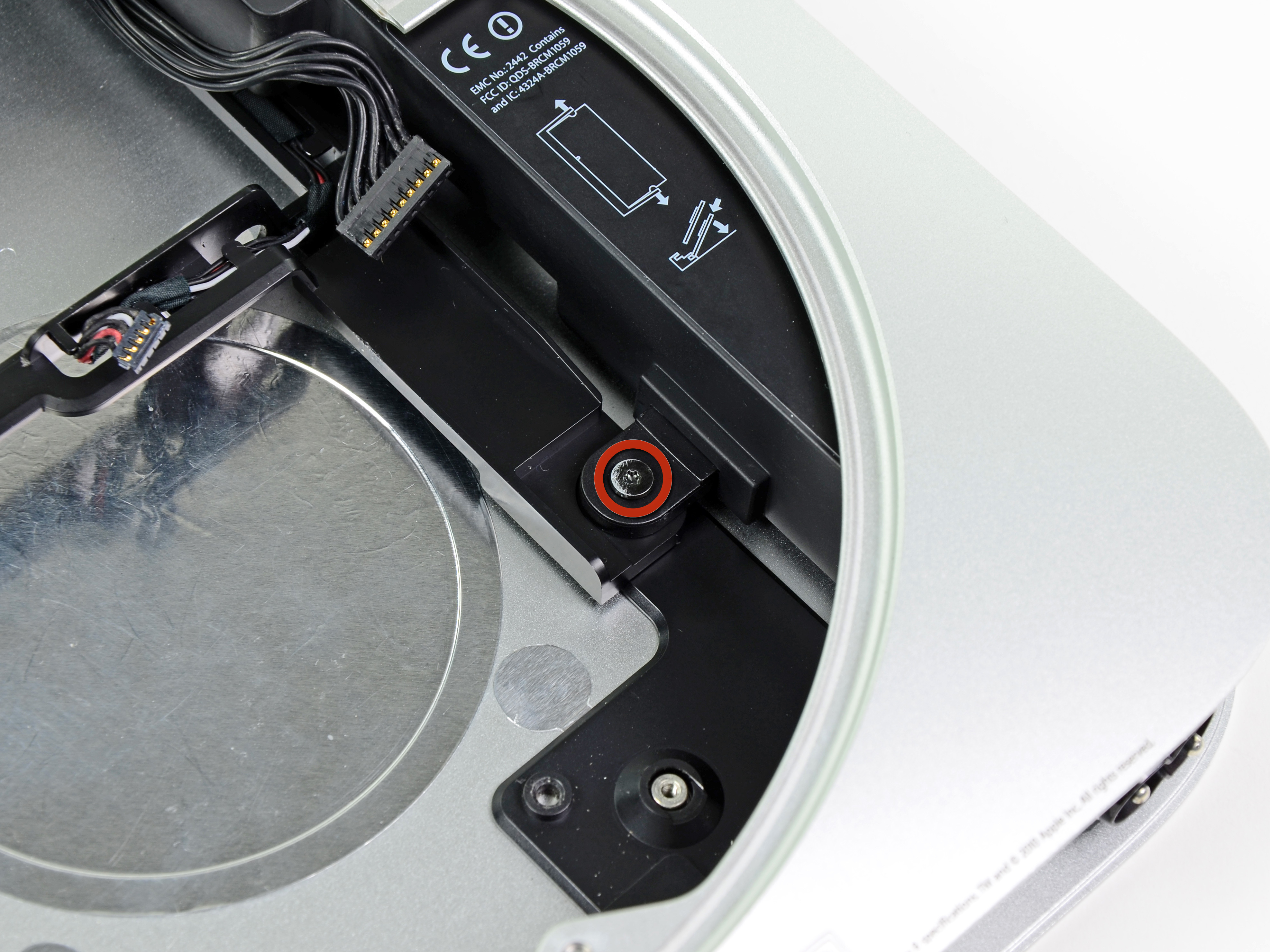

  19. Mac mini Mid 2011 Power Supply Replacement, Power Supply: step 19, image 1 of 1
    • Remove the 7.9 mm T6 Torx screw securing the power supply and hard drive tray to the outer case.
    • During reassembly, ensure the cables that run alongside the hard drive are tucked under the power supply. This will ensure the hard drive is properly seated. In addition, the antenna screw holes will not line up if there are cables in the way.
