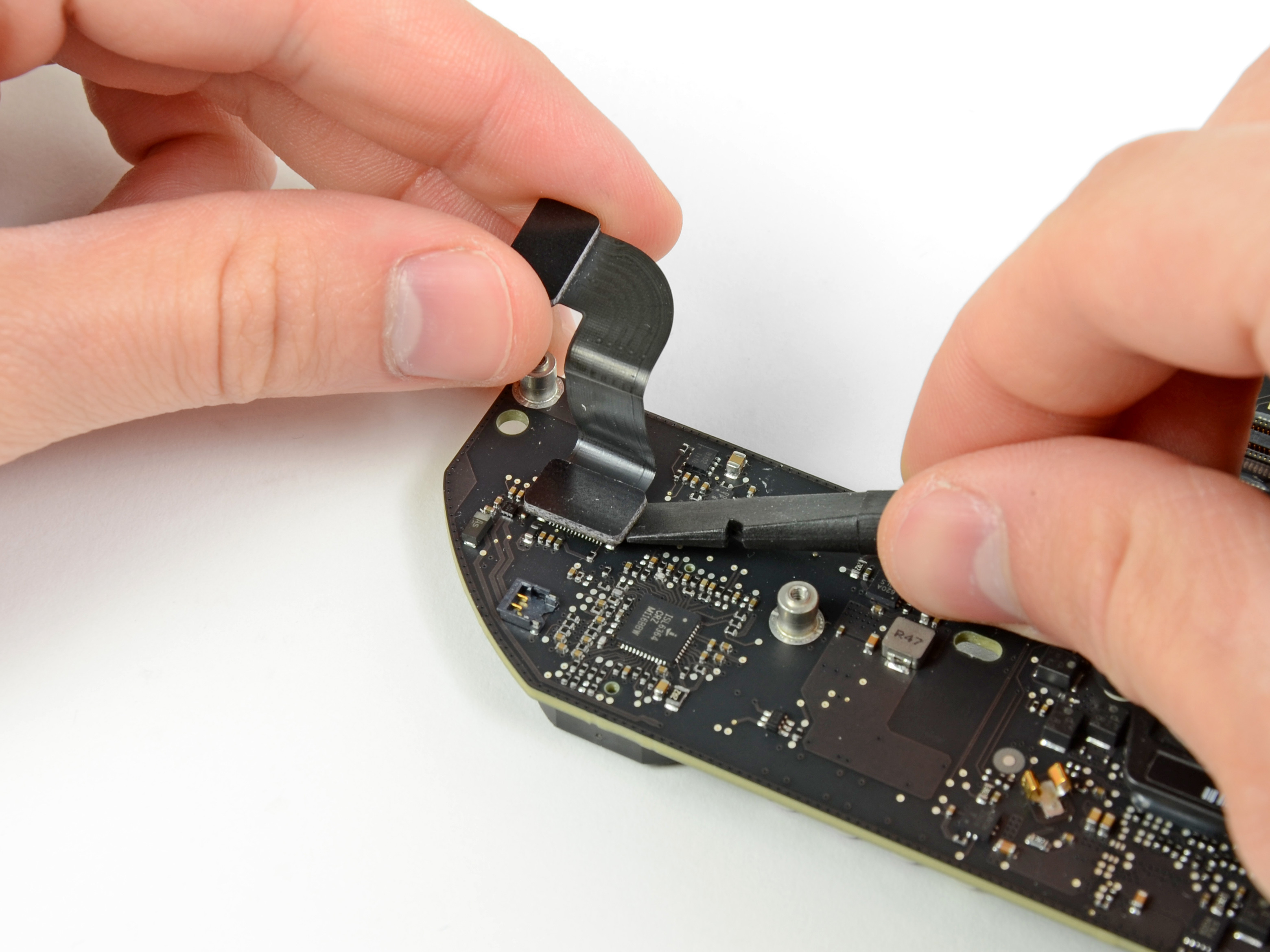

Add Note Edit Step 26 — Logic Board Replacement  ¶
  • Use the flat end of a spudger to pry the AirPort/Bluetooth ribbon cable up off the logic board.
  • Remove the AirPort/Bluetooth ribbon cable.
