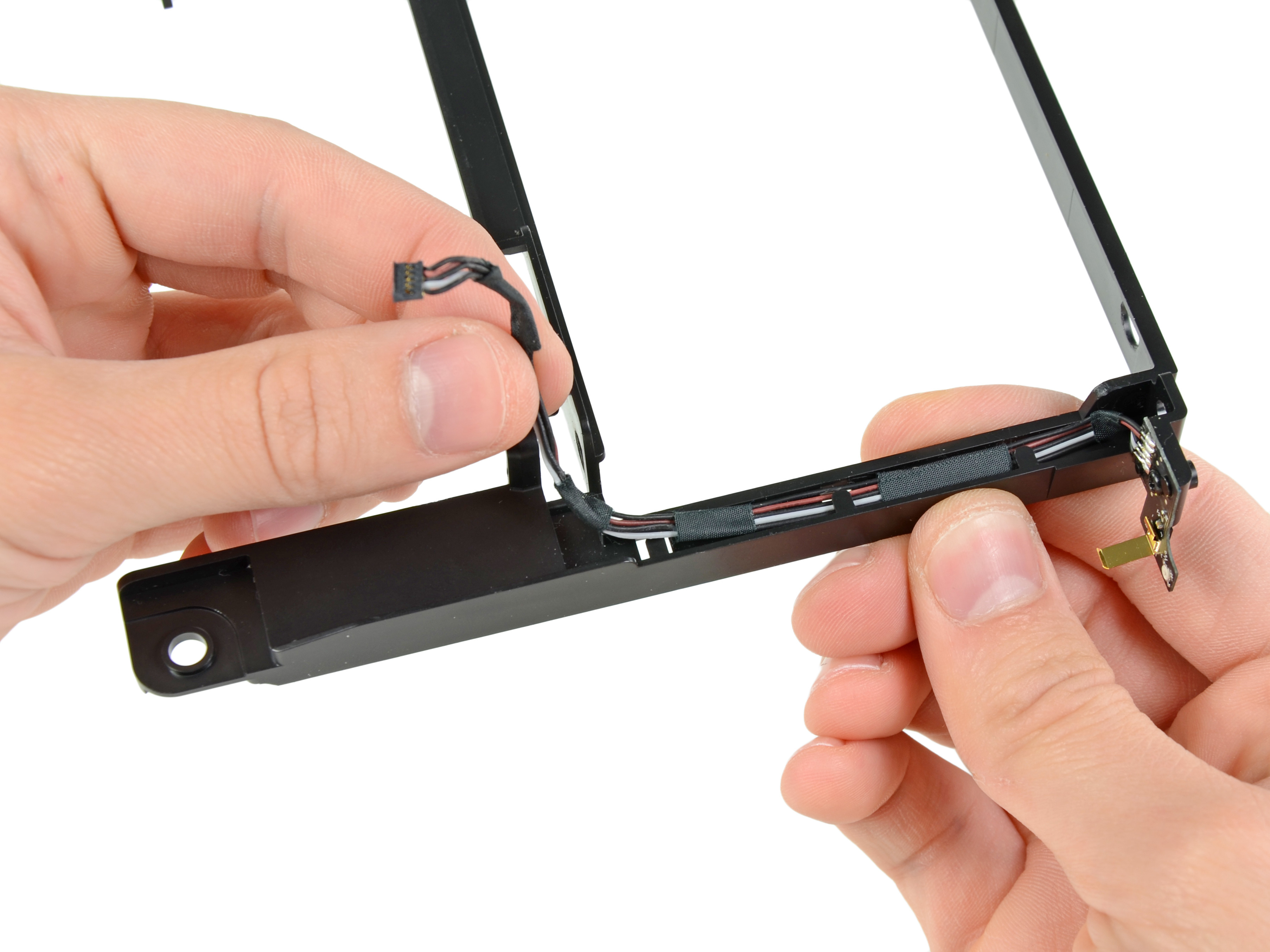

  25. Mac mini Mid 2011 IR Sensor Replacement, IR Sensor: step 25, image 1 of 1
    • Carefully de-route the IR sensor cables from the channel in the hard drive tray.
  26. Mac mini Mid 2011 IR Sensor Replacement: step 26, image 1 of 1
    • Remove the 5 mm Phillips screw securing the IR board to the hard drive tray.
  27. Mac mini Mid 2011 IR Sensor Replacement: step 27, image 1 of 1
    • Remove the IR sensor from the hard drive tray.
    • Be careful when removing the IR board from the hard drive tray, as the lower plastic positioning pin has the tendency to get caught on the delicate IR board.
