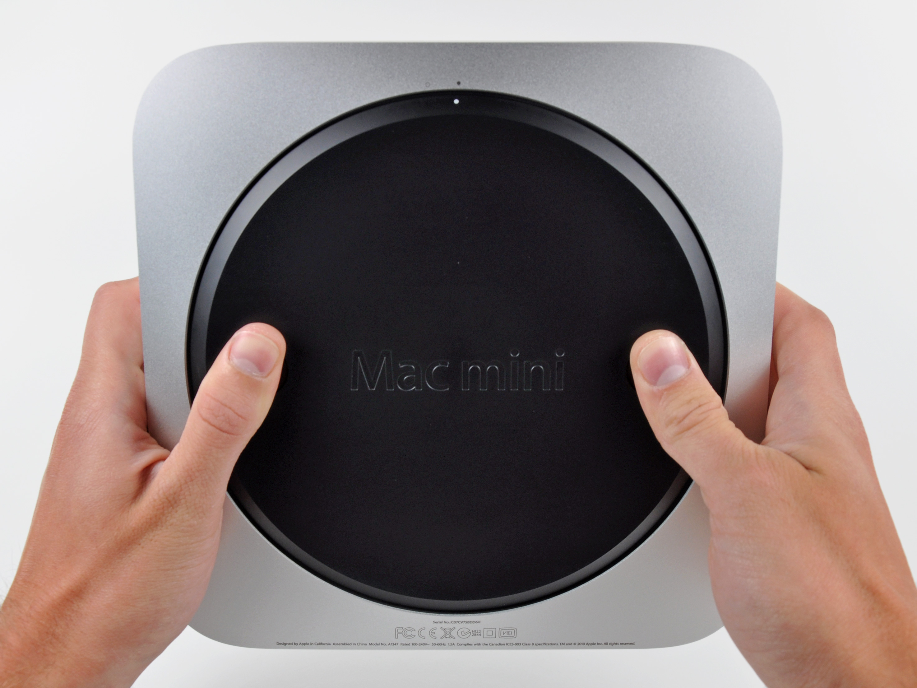

    • Place your thumbs in the depressions cut into the bottom cover.
    • Rotate the bottom cover counter-clockwise until the white dot painted on the bottom cover is aligned with the ring inscribed on the outer case.
    • You do not need to apply much downward pressure while turning.
  2. Mac mini Mid 2011 Bottom Cover Replacement: step 2, image 1 of 1
    • Tilt the mini enough to allow the bottom cover to fall away from the outer case.
    • Remove the bottom cover and set it aside.
