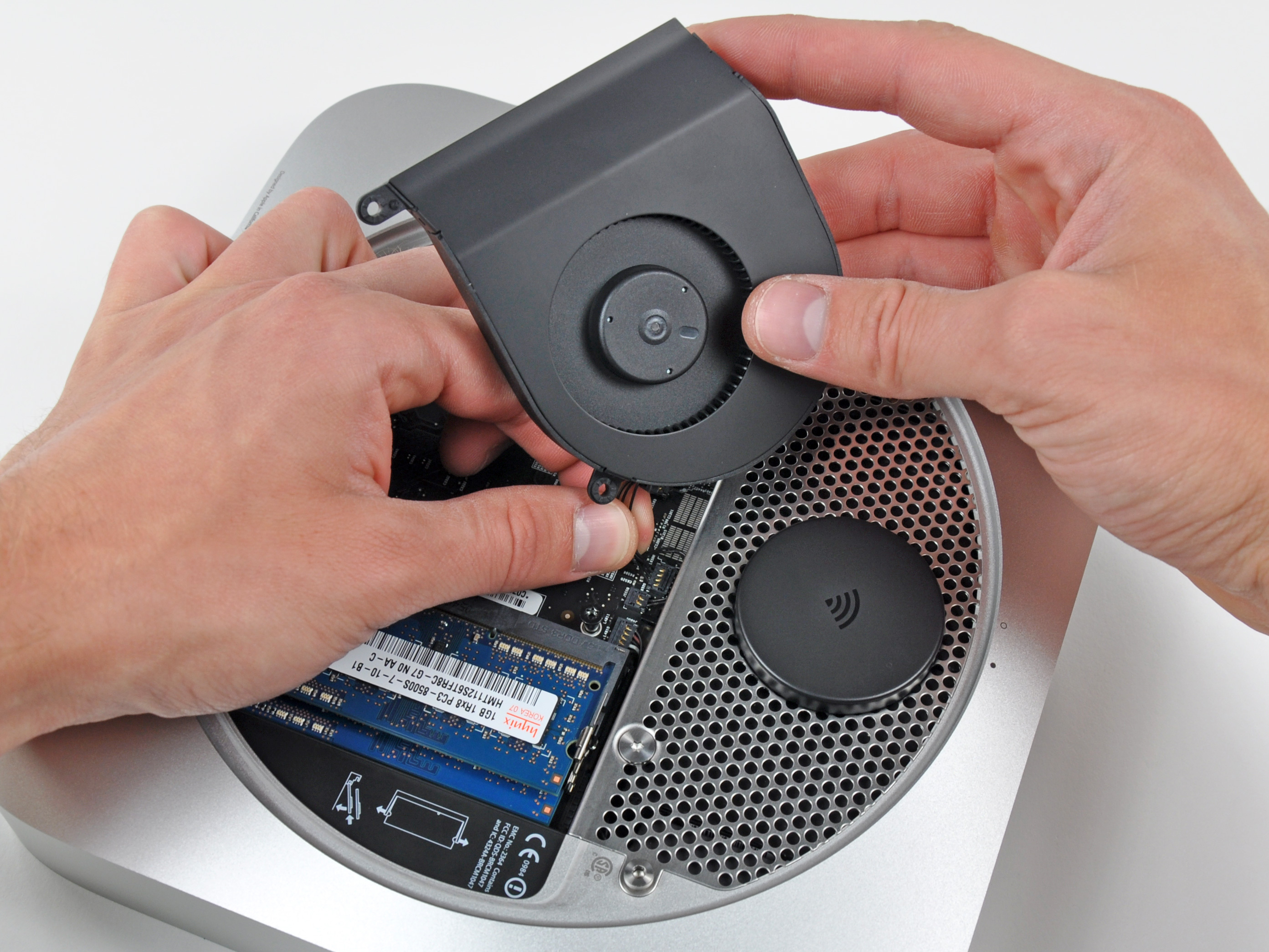

Add Note Edit Step 3 — Fan  ¶
  • Remove the two 11.3 mm T6 Torx screws securing the fan to the logic board near the antenna plate.
Image #1
Add Note Edit Step 4  ¶
  • Lift the ear of the fan nearest the RAM up off the standoff secured to the outer case.
Image #1
Add Note Edit Step 5  ¶
  • Lift the fan out of the mini for enough clearance to access its connector.
  • Carefully pull the fan cables upward to lift the fan connector up out of its socket on the logic board.
  • Remove the fan.
