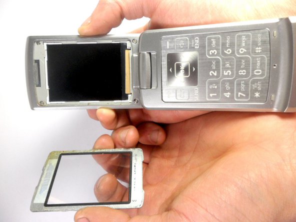

Add Note Edit Step 5  ¶
  • Remove the screen by using the tab to eject the screen.
    • There is a gap between the case and the screen near the ear piece
    • Insert the plastic opening tool in the gap and pry the screen up.
  • The plastic screen cover is glued onto the phone, do not be alarmed if it may be difficult to pry it off.

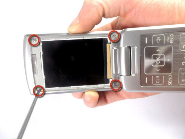

Add Note Edit Step 6  ¶
  • Unscrew the four corner 3.21mm screws to separate the the top cover of the phone

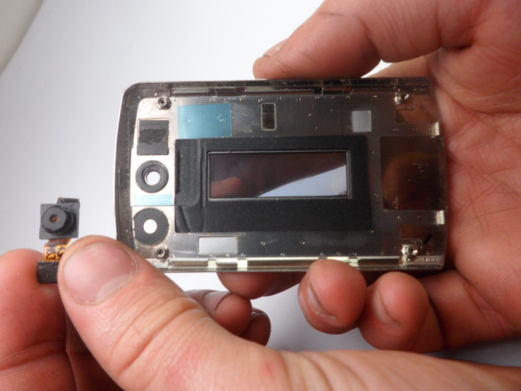

Add Note Edit Step 7  ¶
  • Turn your phone around
  • Remove the top cover of the phone by inserting the plastic opening tool into the groove.
  • Carefully open the cover.

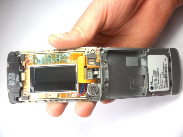

Add Note Edit Step 8 — Camera  ¶
  • Now we have the LCD outer case off. The LCD display can be seen on the left, the camera on the right.
  • Place the phone assembly down, it is not needed anymore.
