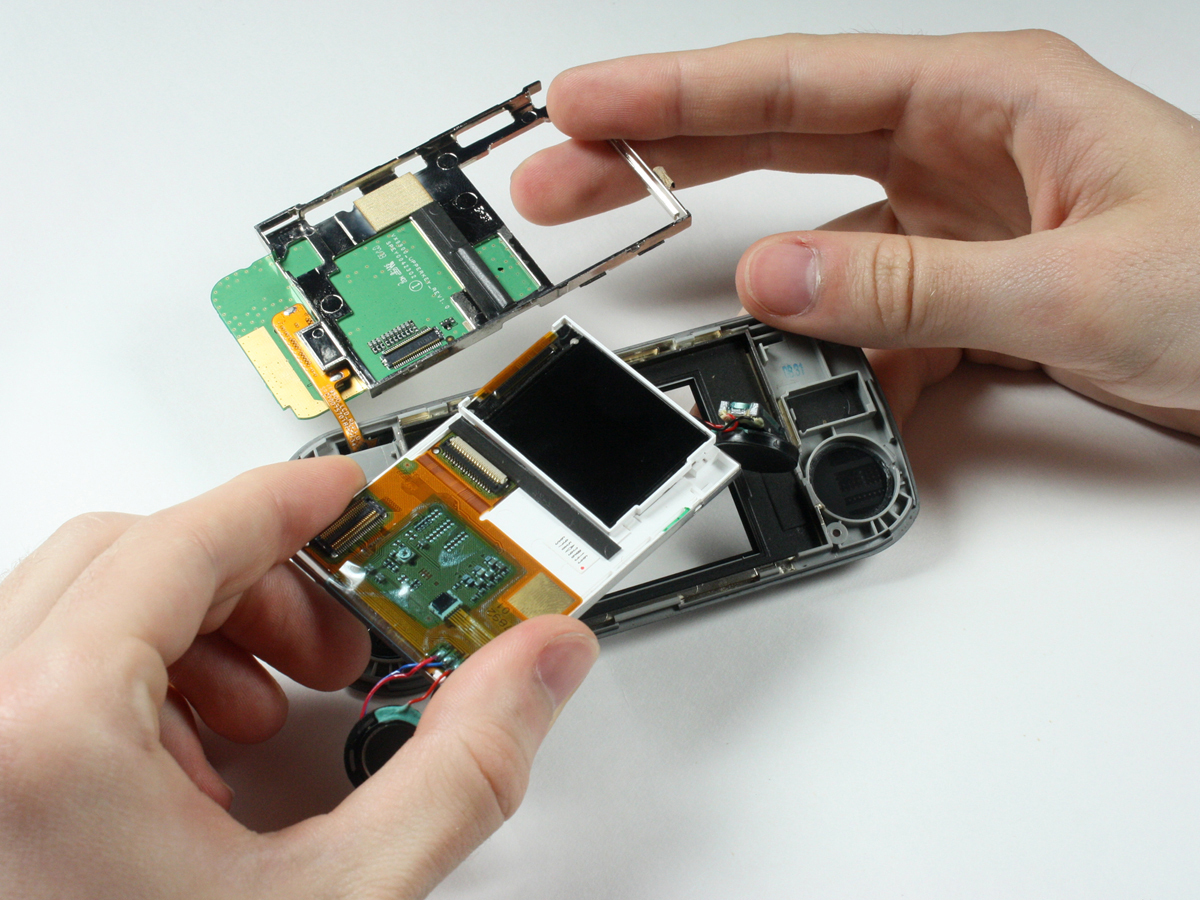

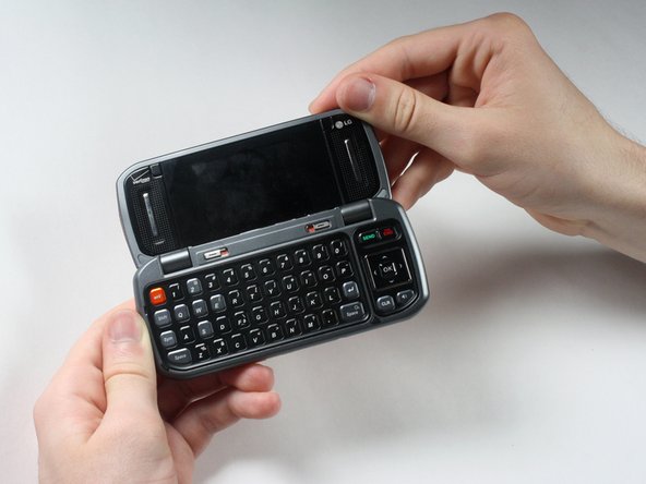

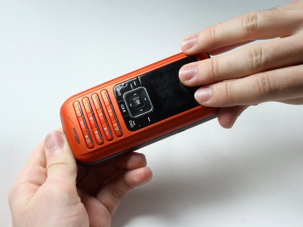

Image #1
  • Place the phone so the screen side is facing down.
  • Locate the latch at the end of the phone, opposite of the camera.
Image #1
Add Note Edit Step 2  ¶
  • Push/pull the latch away from the camera, causing the battery to pop out.
Image #1
Add Note Edit Step 3  ¶
  • Remove the battery.
Image #1 Image #2
Add Note Edit Step 4 — Circuit Board and Full Key Board  ¶
  • Remove the 5 screw covers on the back of the phone using a Push Pin.
Image #1
Add Note Edit Step 5  ¶
  • With a Phillips #00 Screwdriver, remove the five 3.44 mm screws that were under the screw covers.
  • Also with a Phillips #00 Screwdriver, remove the screw that was revealed once the battery was removed.
Image #1 Image #2
Add Note Edit Step 6  ¶
  • Open the phone.
Image #1 Image #2
Add Note Edit Step 7  ¶
  • Starting at the card slot or charger port for greater ease, pry off the colored casing from the back of the phone using the Plastic Pry Tool (or a finger nail may work).
  • Prying open the part just to the left of the right hinge can be difficult.
  • Remove the back colored casing and set it to the side.
Image #1 Image #2

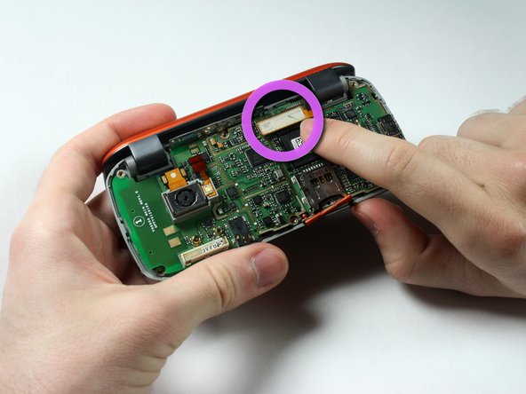

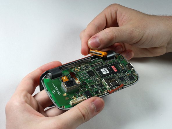

Add Note Edit Step 8  ¶
  • Gently pry and detach the connection located near the hinge with fingers.
