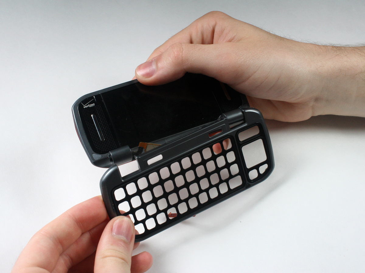

  • Open the phone.
Image #1 Image #2
Add Note Edit Step 7  ¶
  • Starting at the card slot or charger port for greater ease, pry off the colored casing from the back of the phone using the Plastic Pry Tool (or a finger nail may work).
  • Prying open the part just to the left of the right hinge can be difficult.
  • Remove the back colored casing and set it to the side.
Image #1 Image #2
Add Note Edit Step 8  ¶
  • Gently pry and detach the connection located near the hinge with fingers.
