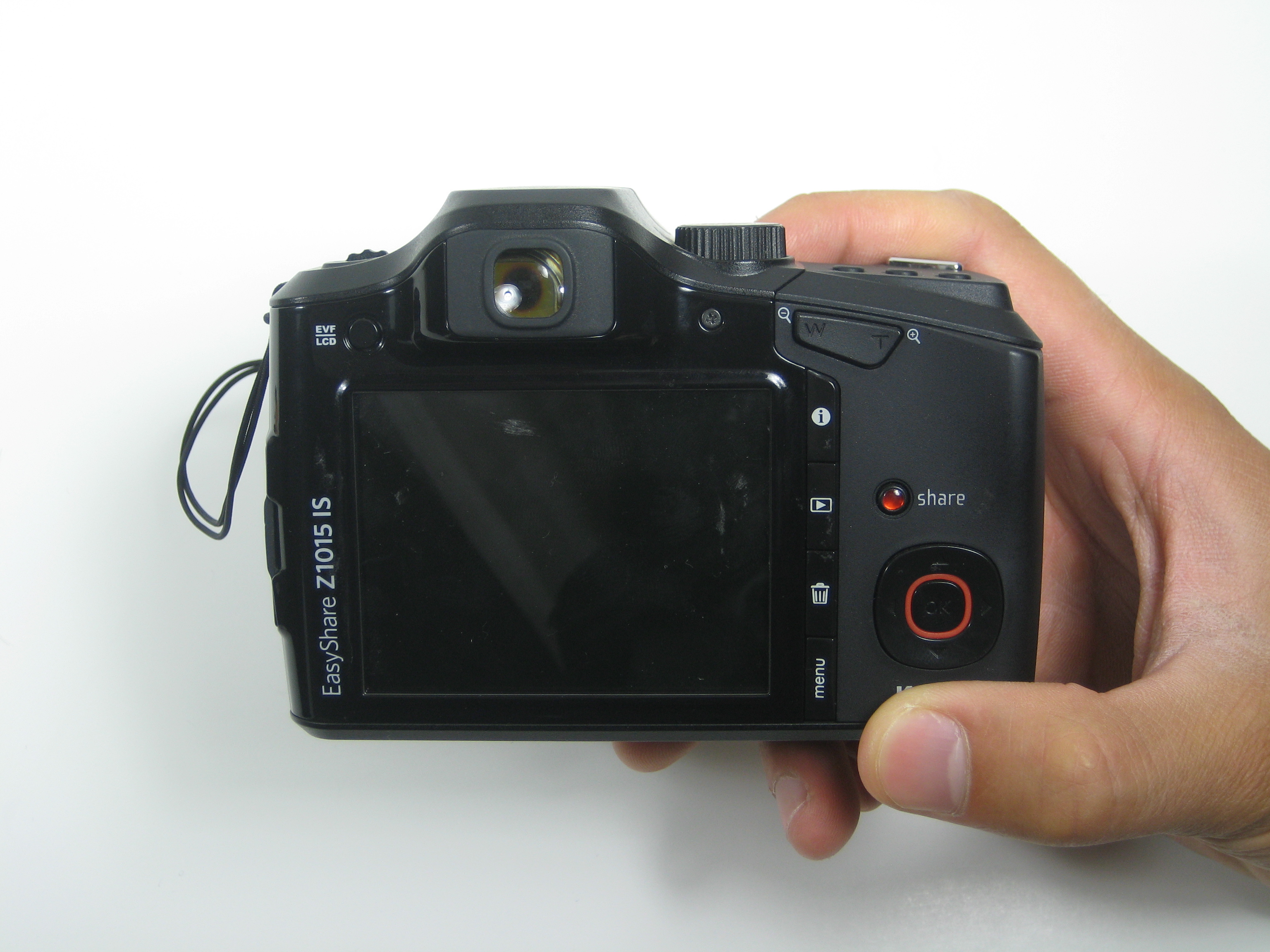

This tutorial demonstrates how to remove the back cover from the camera.
Image #1 Image #2
  • Begin by sliding the switch towards the open symbol. Release your finger from the switch and the battery case will pop open.
Image #1
Add Note Edit Step 2  ¶
  • Next, press down on the red lever which holds the battery in place.
Image #1 Image #2
Add Note Edit Step 3  ¶
  • Once the battery has popped out of the compartment, simply pull it out of the camera.
Image #1 Image #2 Image #3
Add Note Edit Step 4 — Back Cover  ¶
  • Make sure that the lens cover is on the Kodak EasyShare whenever working with one of these guides.
  • Also, make sure to keep track of the screws you remove throughout these step by step guides. Losing a screw could inhibit the ability to reassemble the camera.
  • Begin by removing the first screw located on the back of the camera.
Image #1 Image #2
Add Note Edit Step 5  ¶
  • Next, remove the two screws located on the right side of the camera.
Image #1 Image #2
Add Note Edit Step 6  ¶
  • After removing the screws located on the right side, remove the six screws located on the bottom of the camera.
Image #1 Image #2
Add Note Edit Step 7  ¶
  • Lastly, remove the two screws located on the left side of the camera.
Add Note Edit Step 8  ¶
  • Once all eleven screws have been removed, use Plastic Opening Tools to take off the back cover.
    • Insert the plastic opening tool and apply leverage on each side of the camera. The recommended spots to apply leverage are shown in these pictures.
