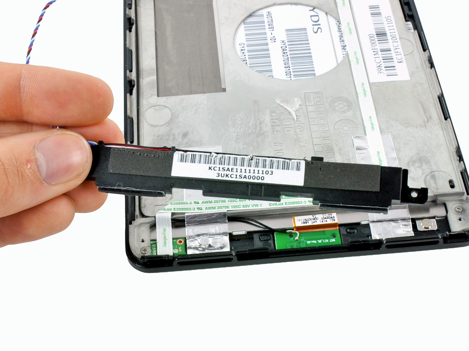

Add Note Edit Step 6 — Speaker Assembly  ¶
  • Peel the tape on the upper-left IC that is securing the speaker cable.
  • Use the flat end of a spudger to push the speaker connector out of its socket.
  • Deroute the speaker cable.
Image #1 Image #2
Add Note Edit Step 7  ¶
  • Remove the two 3.3 mm Phillips #00 screws securing the speakers to the Kindle Fire.
  • Lift the speakers out of the Kindle Fire.
