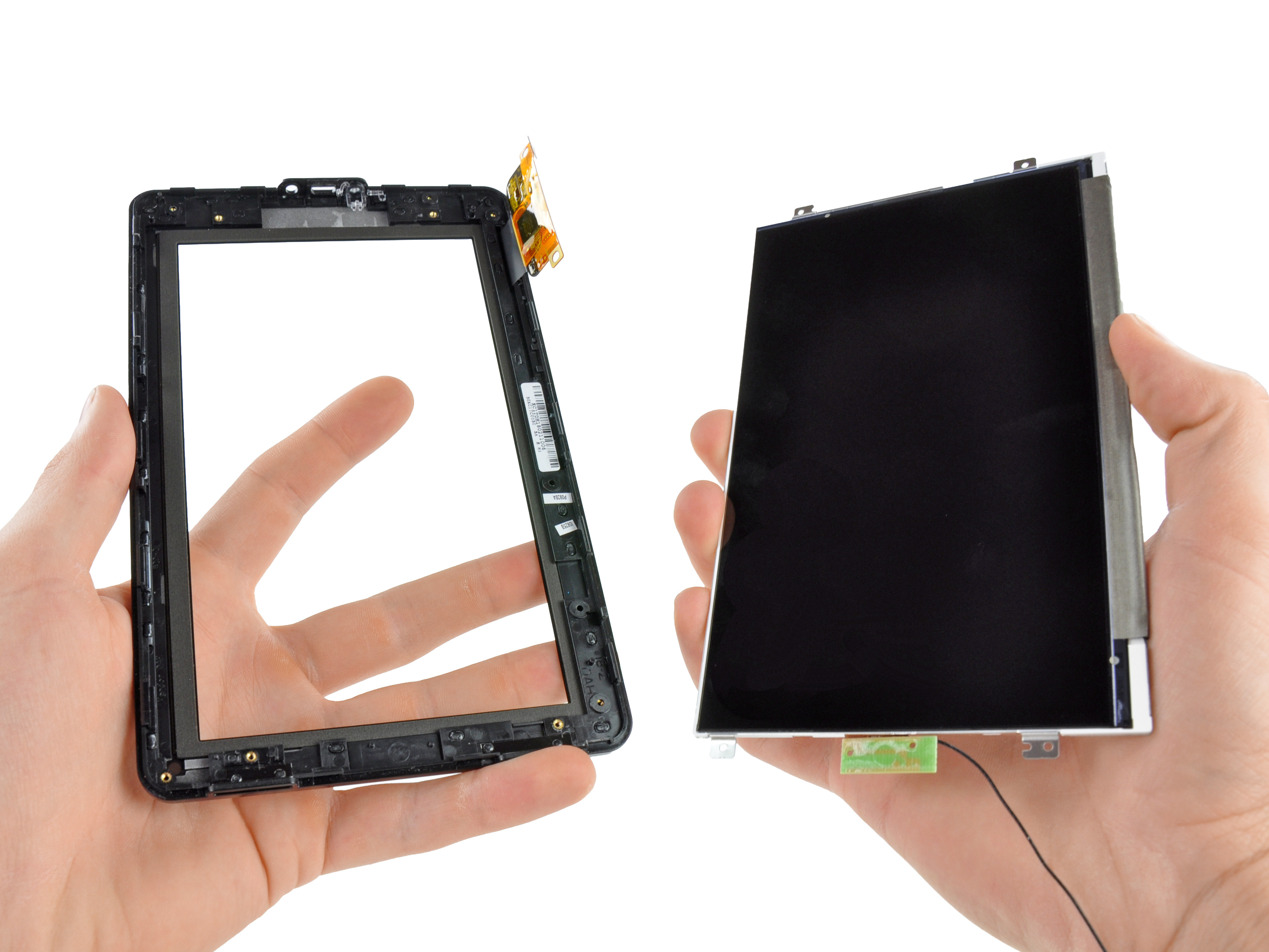

Use this guide to help you replace the LCD in an Amazon Kindle Fire.

Add Note Edit Step 1 — Back Case  ¶
  • Wedge a plastic opening tool into the lower right corner of the Kindle Fire.
  • Pry the case apart and run the plastic opening tool along the perimeter of the Kindle Fire to release the clips securing the case halves to each other.
  • If you are having extreme difficulty inserting the plastic opening tool, carefully use a metal spudger to undo the first clip, then switch back to the opening tool to avoid scratching your case.
    • It is helpful to pry the bottom of the Kindle Fire away (and out from the side) from the top part. Exerting too much force attempting to split the two without pulling away can cause the tabs on the inside to crack.
