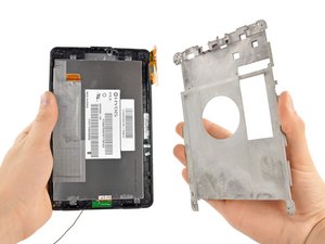

Add Note Edit Step 8 — Motherboard  ¶
  • Remove the two 2.3 mm Phillips #00 screws from the touchscreen controller.
  • Use a plastic opening tool to release the touchscreen controller connector.
  • Gently remove the touchscreen controller by lifting it up and to the right.
    • Be careful not to rip the ribbon cable in doing so.
