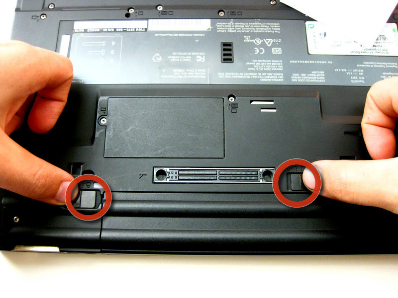

Changing the battery is easy -- you don't need a any tools.
Image #1
  • Slide the 2 sliders on the under side of the laptop to the unlock position, as shown.
Image #1
Add Note Edit Step 2  ¶
  • Grasp the battery and pull it straight out - not at an angle.
