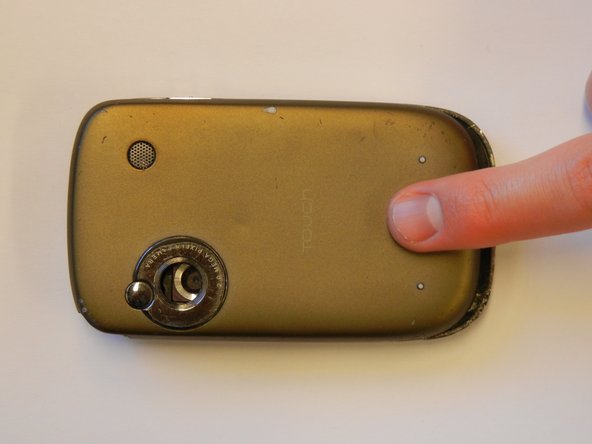

  • Remove the back panel by sliding it up.

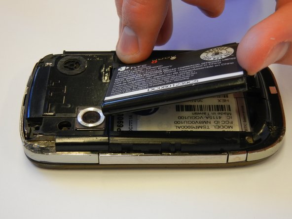

Add Note Edit Step 2  ¶

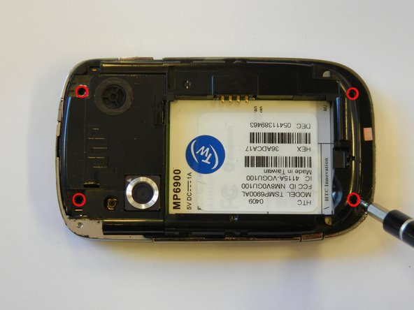

  • Remove the battery.
Image #1
Add Note Edit Step 3  ¶
  • Remove the 4 torx-head screws in the corners of the phone using the T5 Torx Screwdriver.

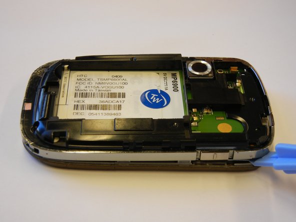

  • Use the plastic opening tool to remove the front panel from the phone.

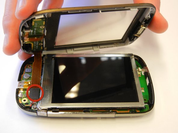

  • Unplug the front button cable from the inside of the phone.

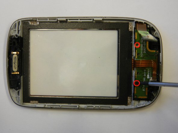

  • Remove the 2 philips-head screws on the back of the front panel using the PH00 screwdriver.

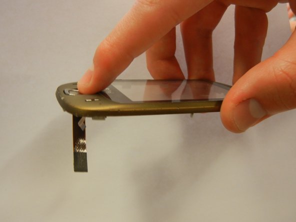

Add Note Edit Step 6  ¶

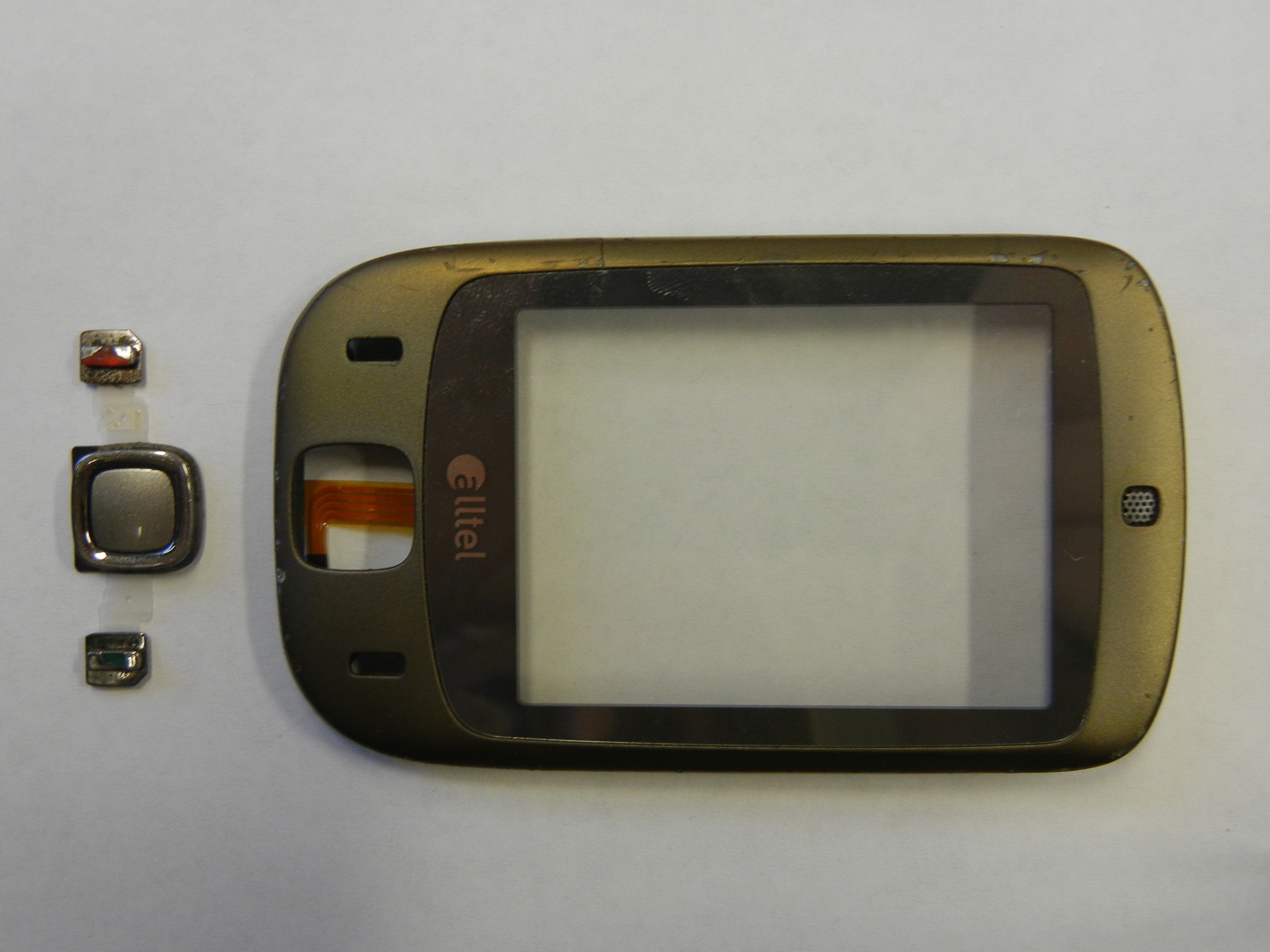

  • Remove the small circuit board by gently pushing on the center button on the front of the phone.
Image #1
Add Note Edit Step 7  ¶
  • Remove the buttons by pushing on them from the front side of the phone.
