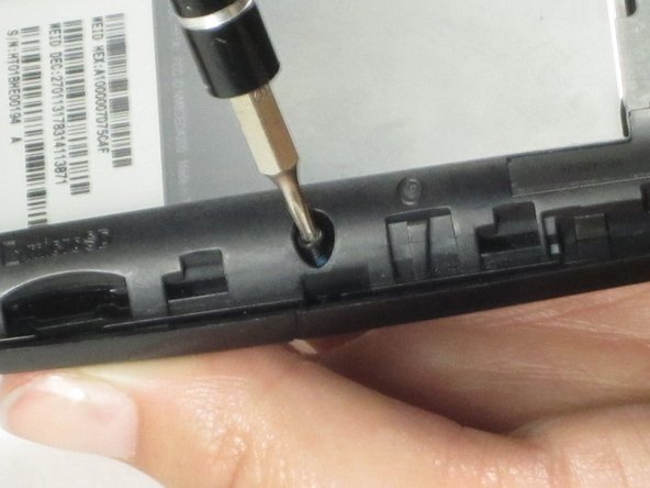

Add Note Edit Step 4 — Keyboard  ¶
  • To remove the back casing inside the phone, unscrew the 6 screws that are around the perimeter of the phone.

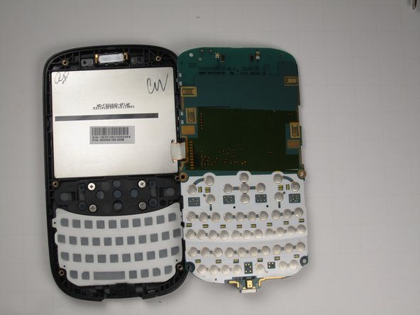

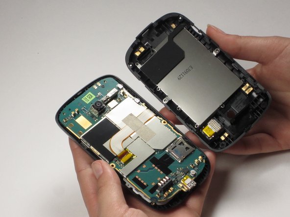

Add Note Edit Step 5  ¶
  • Carefully pull off back casing.
  • Warning: This can be difficult, but just start pulling the back out from the front shell. As it starts to lift up, continue moving around the phone until the whole back becomes free.
Image #1 Image #2

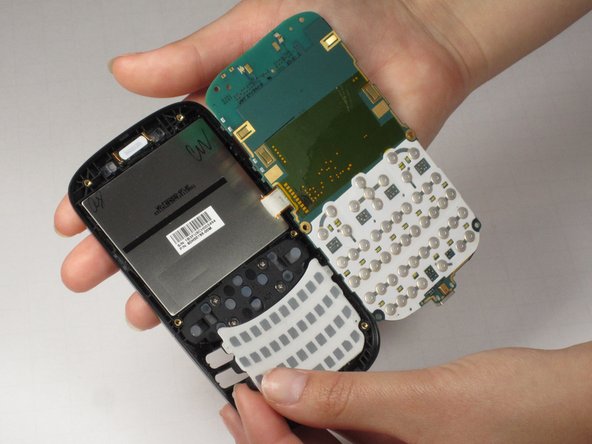

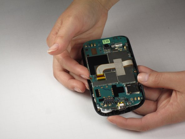

Add Note Edit Step 6  ¶
  • Next unscrew the top screw.
  • Warning: Be CAREFUL because the LCD screen is still attached to the front side of the motherboard by a flexible ribbon cable.

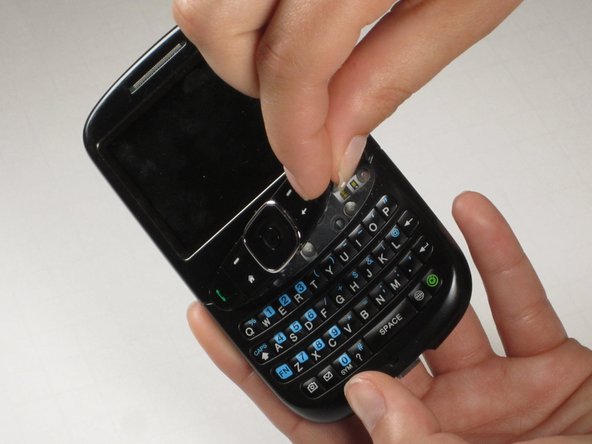

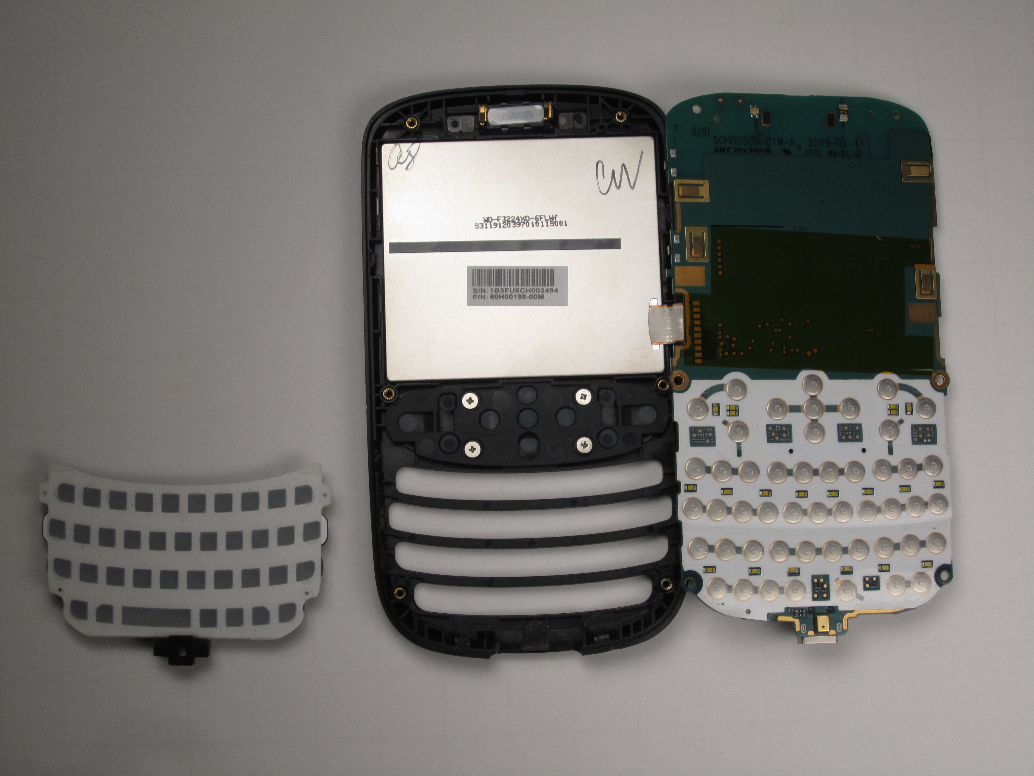

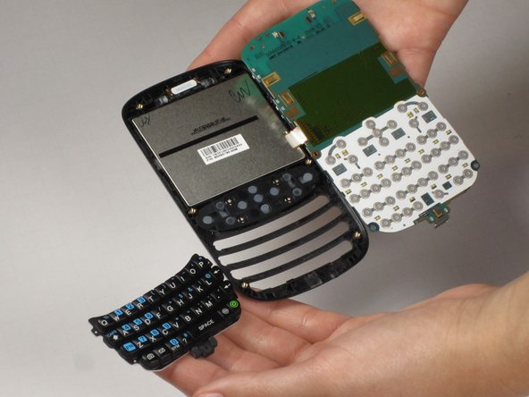

Add Note Edit Step 7 — QWERTY Keyboard  ¶
  • Pull the plastic keyboard away from the front case.
Image #1 Image #2 Image #3

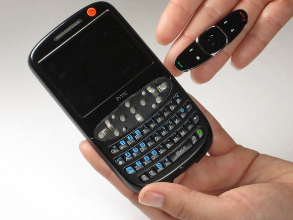

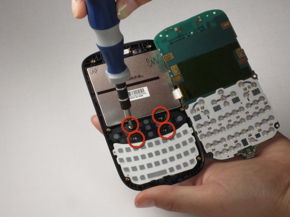

Add Note Edit Step 8 — Navigation Keys  ¶
  • To remove the navigation keys on the front of the phone, unscrew the four screws circled using a Philips screwdriver.
  • Remove the navigation keys from the front of the phone. They should pop out as a unit.
