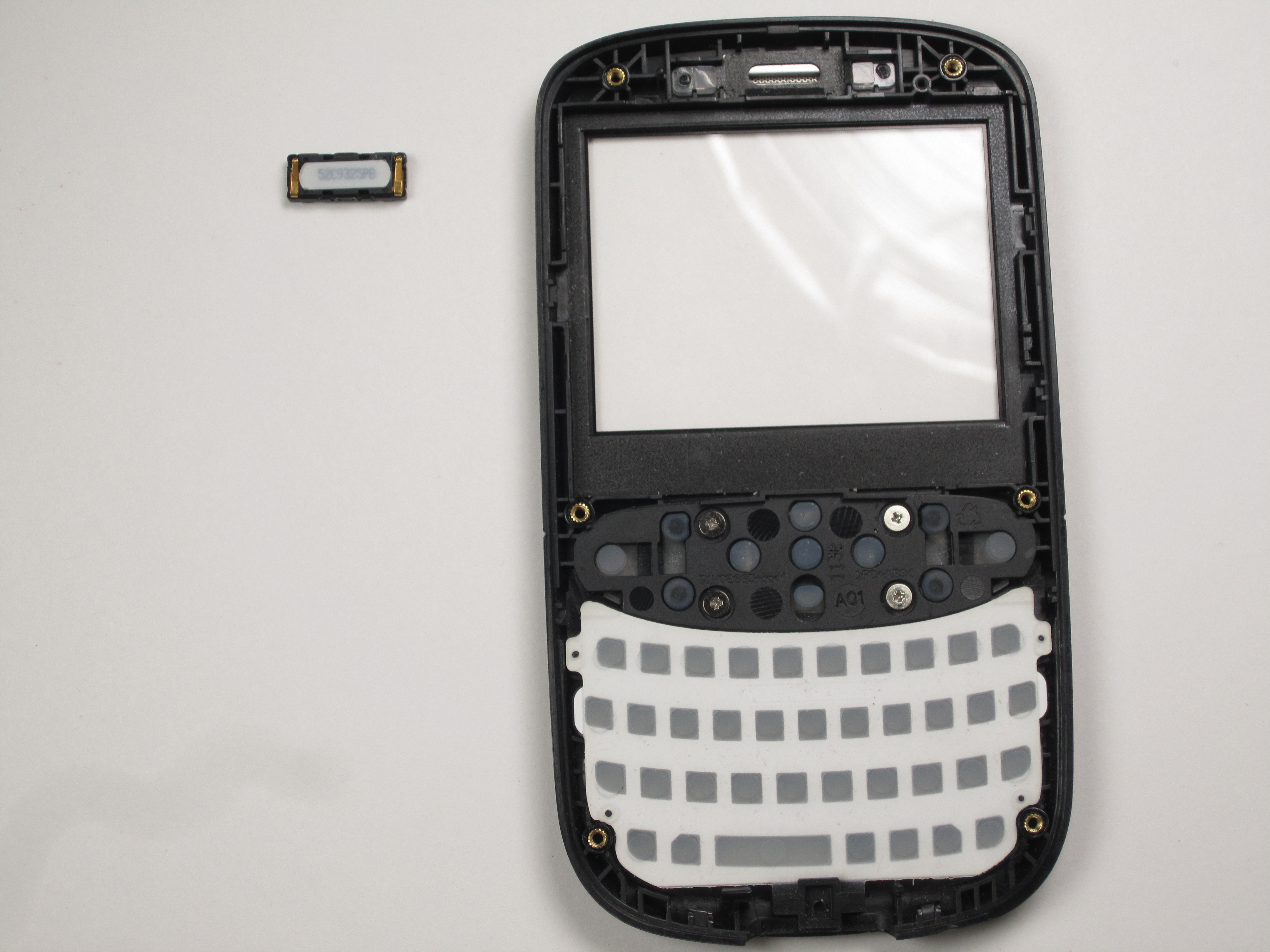

Taking out the ear speaker in the front of the phone.
  • Author: Luke Plewa
  • Time required: 5 minutes
  • Difficulty: Moderate
The ear speaker is the speaker with which the user puts up to their ear when speaking on the phone.

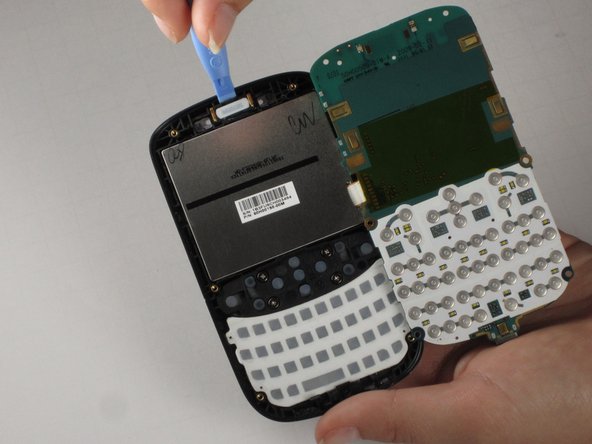

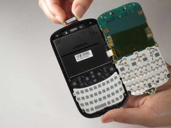

Add Note Edit Step 7  ¶
  • Flip over the motherboard so that the front case is visible.
  • Using a spudger, pull the speaker out of its holding cell inside the front case of the phone.
