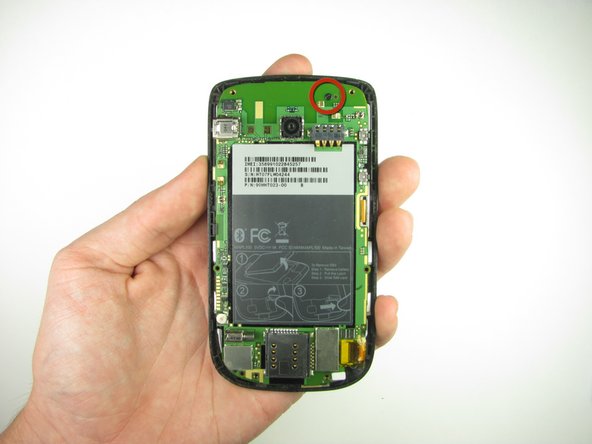

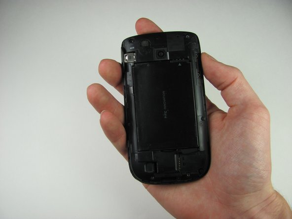

Image #1
  • First remove the back cover of your phone to expose the battery.
Image #1
Add Note Edit Step 2  ¶

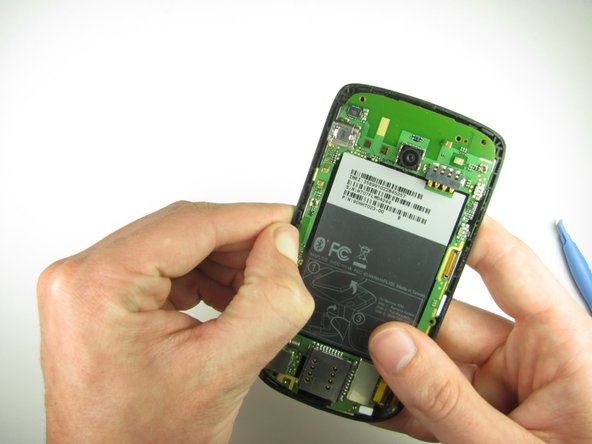

  • Turn the phone over and remove the battery by using your thumb to push forward on the battery and then lift it.

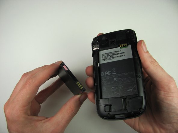

Add Note Edit Step 3  ¶

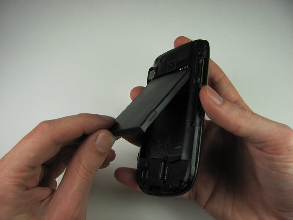

  • Take the battery out
  • When reassembling, make sure that the battery contacts match up.

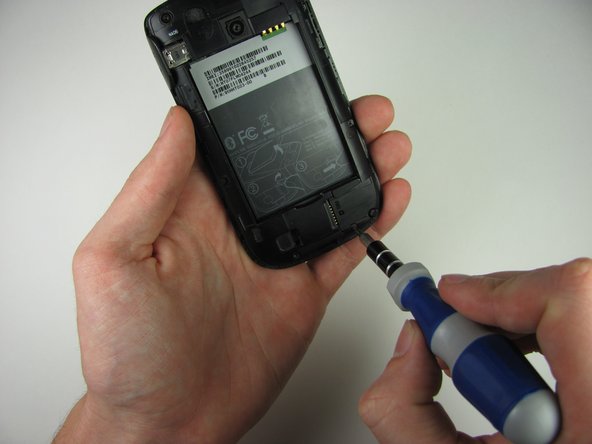

Add Note Edit Step 4 — Back Panel  ¶

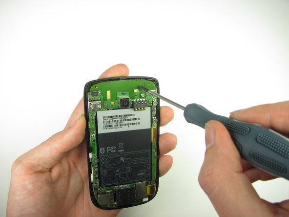

  • Remove the four 4.9mm T6 Torx screws that secure the back panel to the rest of the phone
Image #1
Add Note Edit Step 5  ¶
  • Remove the two 4.3mm #00 Phillips screws that secure the back panel to the rest of the phone

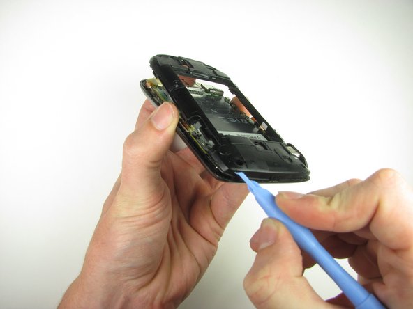

Add Note Edit Step 6  ¶

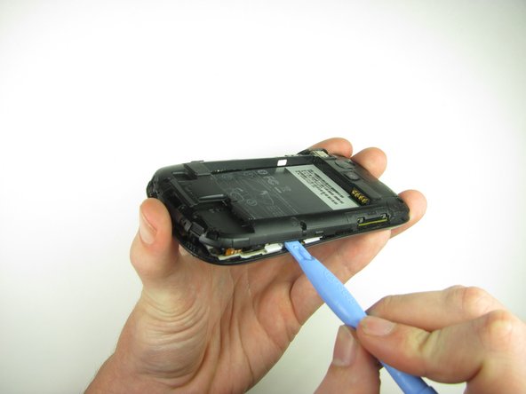

  • Use the plastic opening tool to pry the clips off
  • Insert the plastic opening tool along the seams at different points to it pry up
  • This may require a bit of force. The USB port cover may fall off in this step.
Image #1 Image #2

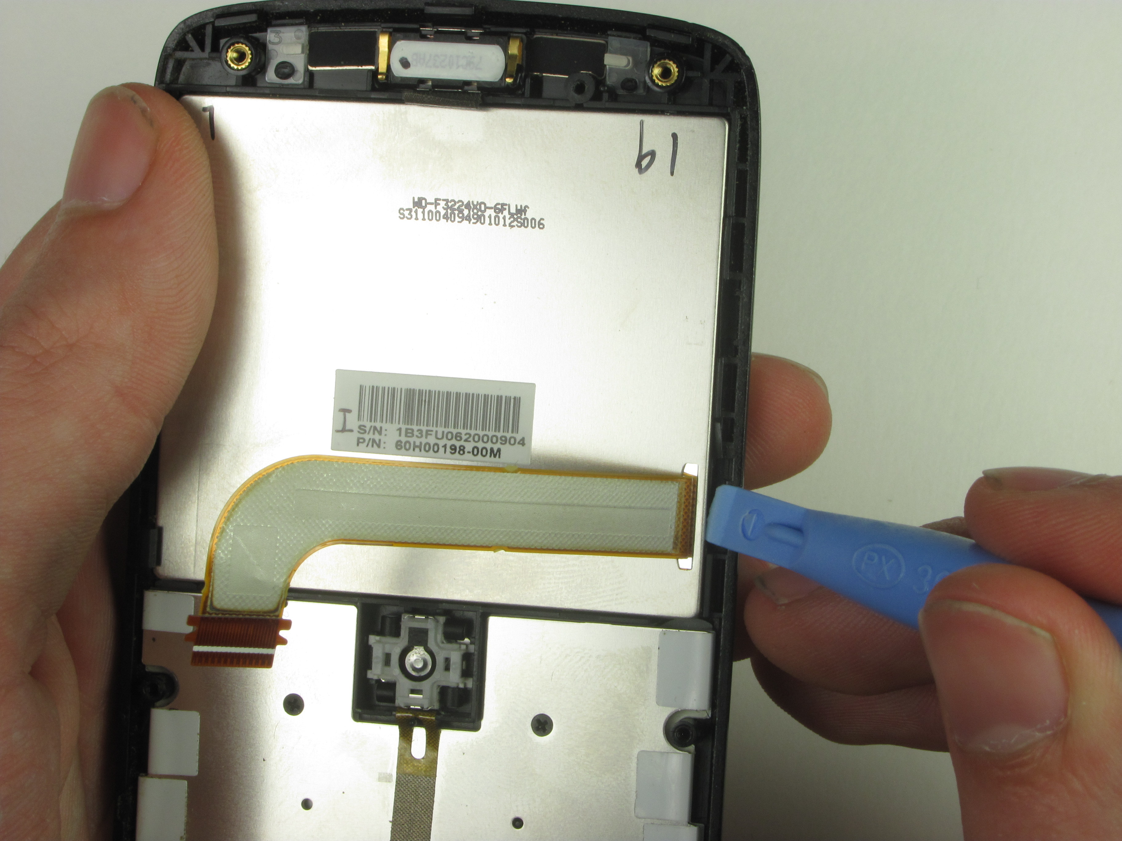

Add Note Edit Step 8  ¶
  • Use your finger or the plastic opening tool to unclip the board.
  • Be aware of the ribbon cable connected to the motherboard inside the phone.
