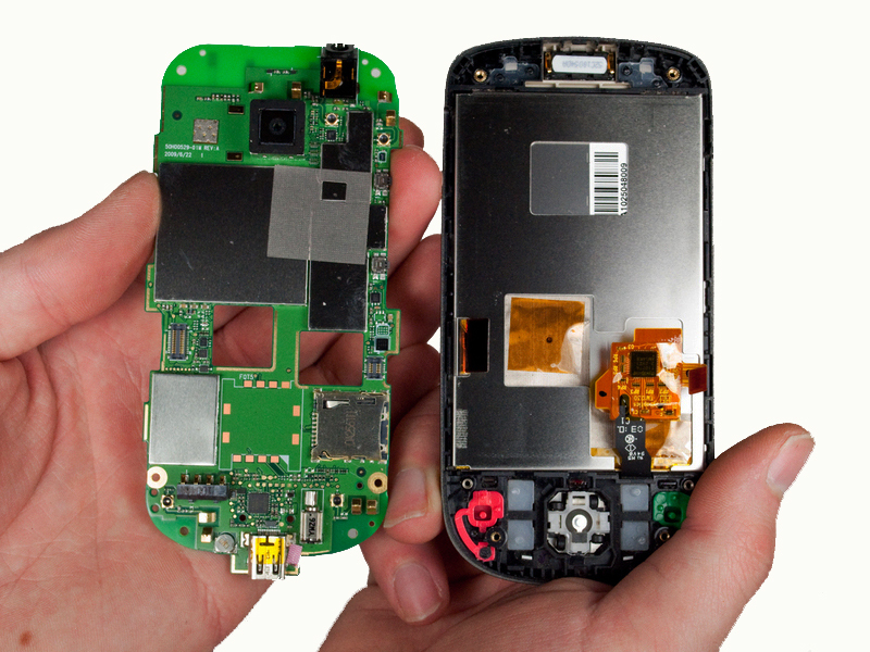

Add Note Edit Step 6  ¶
  • Carefully separate the front and back enclosures once all of the clips have been disengaged.
  • Be sure to not separate too quickly or you risk breaking an attached tab.
Image #1 Image #2

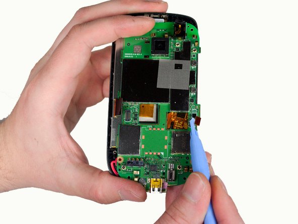

Add Note Edit Step 7 — Motherboard  ¶
  • Release the two ribbon cables using a plastic opening tool.
  • Gently pry up the pop connectors used to attach the ribbon cables to the motherboard.
Image #1 Image #2

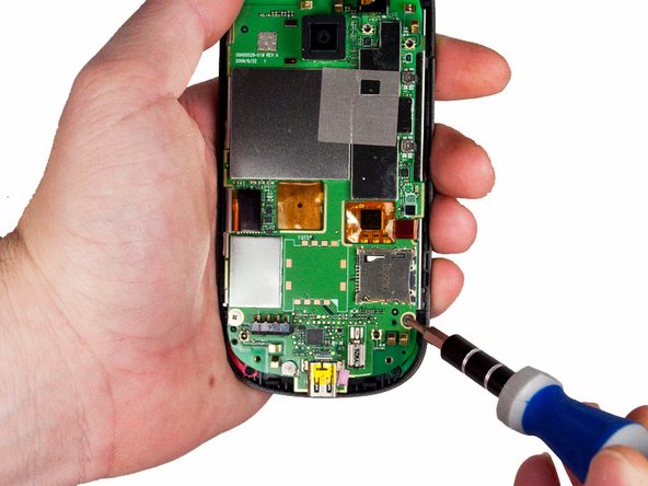

Add Note Edit Step 8  ¶
  • Remove the two screws located at the bottom left and right of the motherboard using a small Phillips screwdriver.
