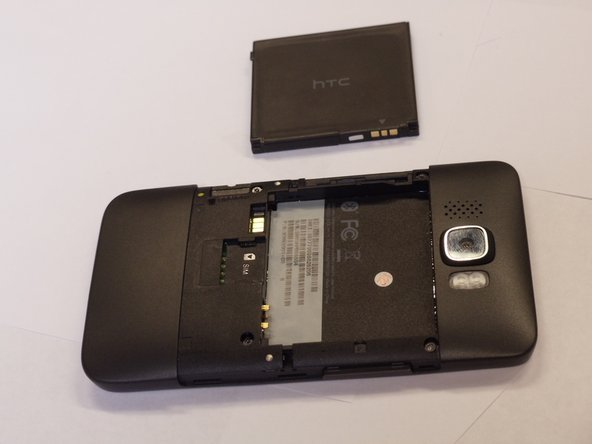

  • Flip the phone 180 degrees
  • Lift up on the lip and the battery should lift up like its hinged to the phone
Image #1
Add Note Edit Step 3  ¶
  • Now you can pull out the battery

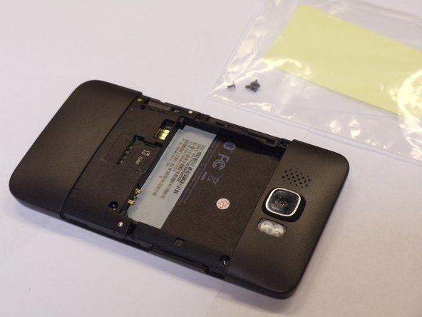

  • Use the T5 Torx screwdriver head to remove 4 black, 3.5mm screws
  • Reminder: Remember to put the screws away and to separate appropriate screws for easy reassembly.

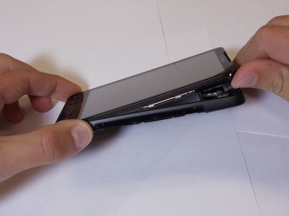

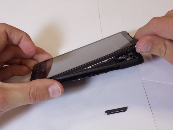

  • Turn the phone to the right side or whatever position works best for using the spudger.
  • Insert the spudger between the chassis and screen.
  • Once the phone and chassis begin to separate, move the spudger around the whole phone to further unseat the phone.
  • Using the spudger for leverage, pry the chassis away from the rest of the phone.
    • This may take much more force than seems safe, but keep at it until the chassis begins to detach.
    • The volume control tab will fall off during removal. Do not worry when it does, it can be easily reattached.
Image #1 Image #2

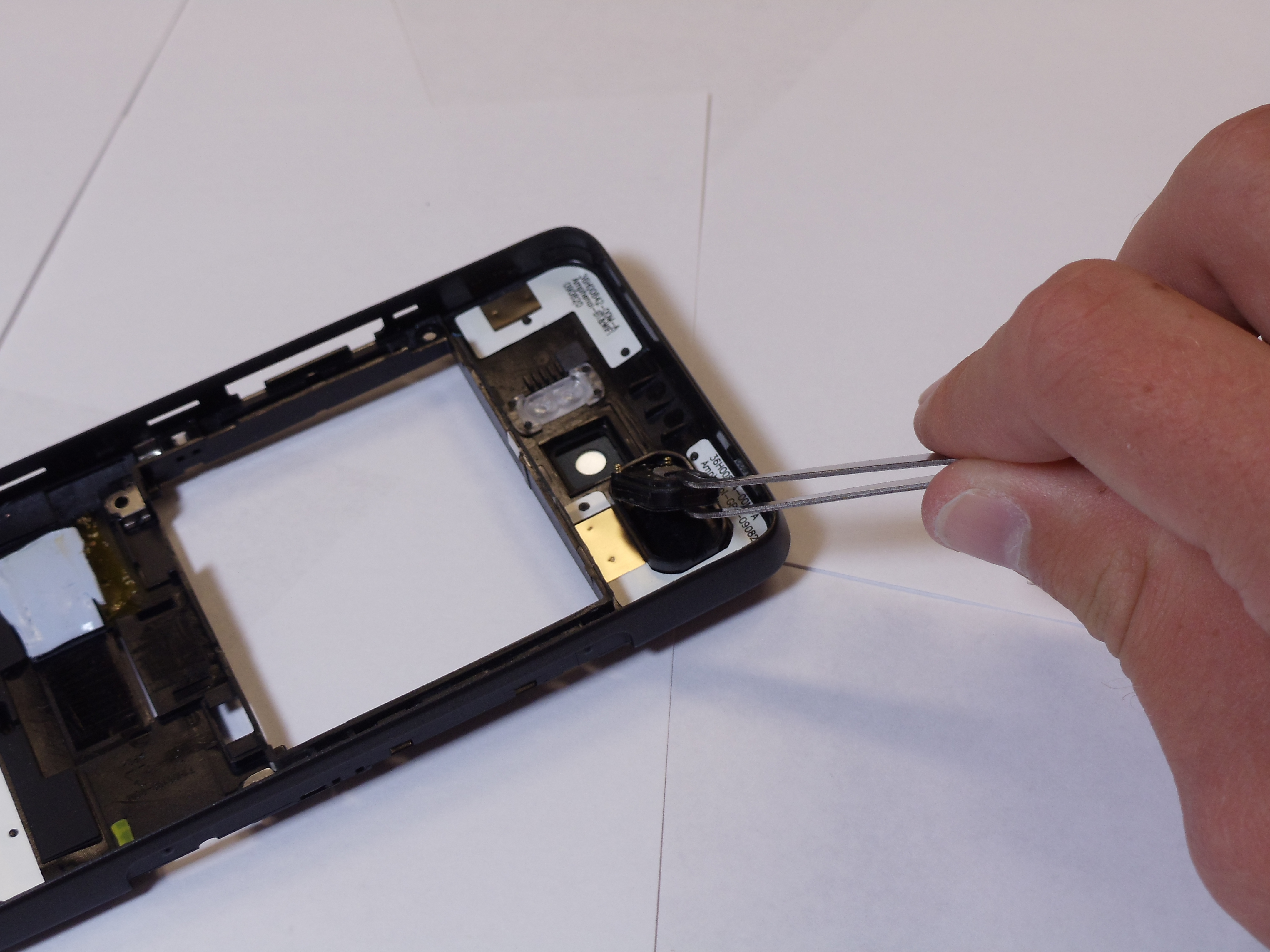

Add Note Edit Step 8 — Phone Speaker  ¶
  • With the chassis removed, set down the phone and locate the speaker on the inside of the housing.
  • The speaker should be easily popped out of place with a small amount of force
