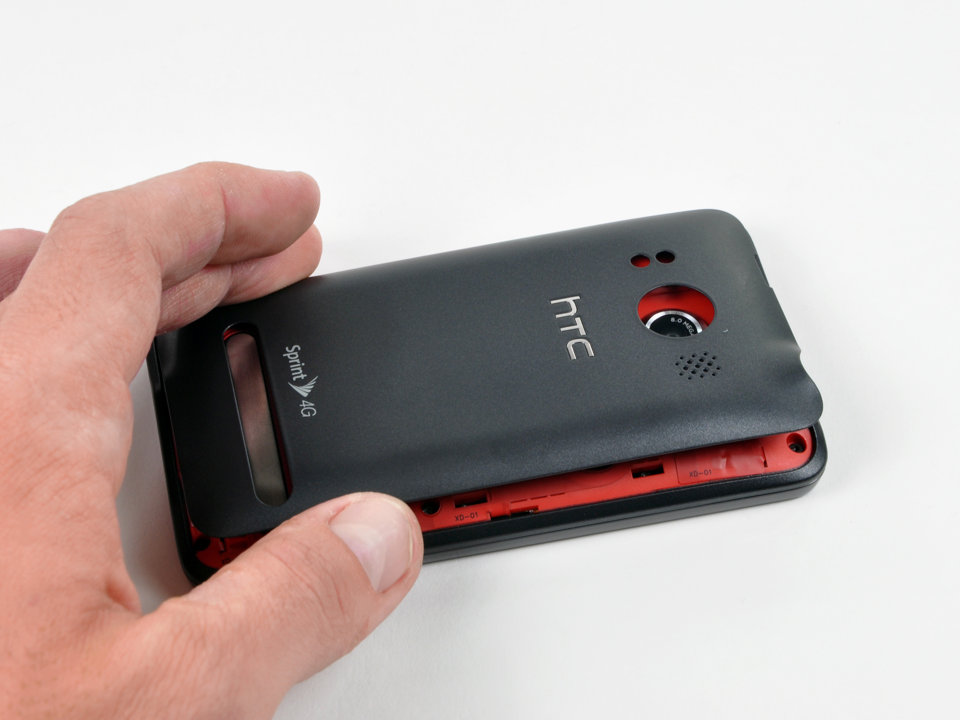

Rear panel replacement.
Use this guide to replace a worn out or scratched rear panel.
Image #1
Add Note Edit Step 1 — Rear Panel  ¶
  • Gently insert an iPod opening tool between the rear panel and the inner rear frame near the headphone jack.
  • Use your iPod opening tool to pry up the rear case around the perimeter of the Evo.
Image #1
Add Note Edit Step 2  ¶
  • Lift the rear panel off of the inner rear frame.
