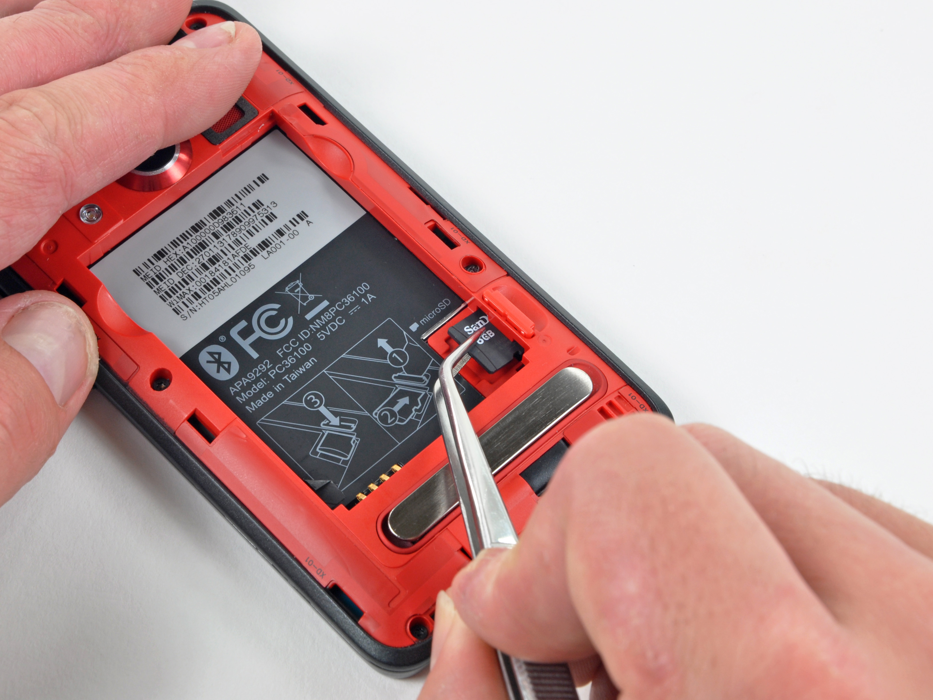

Image #1
Add Note Edit Step 4 — MicroSD card  ¶
  • Use the flat end of a spudger to pry up the red MicroSD retainer attached to the inner frame.
  • The retainer will move about 1 mm and stop. Do not attempt to completely remove the MicroSD card retainer.
Image #1
Add Note Edit Step 5  ¶
  • Use a pair of tweezers to carefully pull the MicroSD card out of its slot in the inner rear frame.
