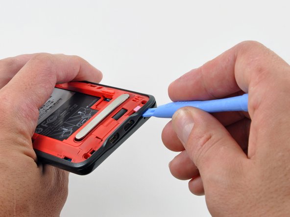

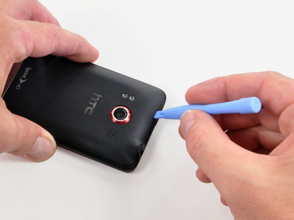

    • Gently insert an iPod opening tool between the rear panel and the inner rear frame near the headphone jack.
    • Use your iPod opening tool to pry up the rear case around the perimeter of the Evo.

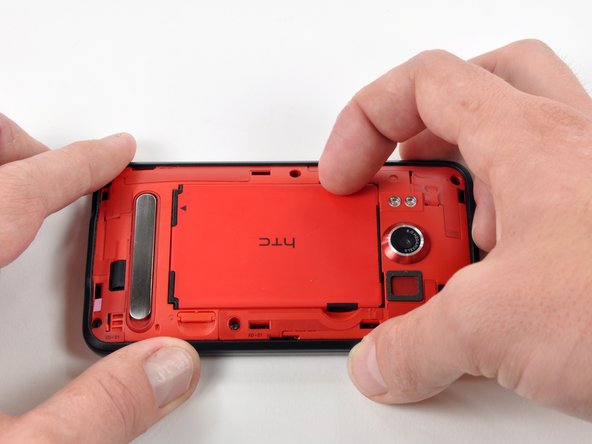

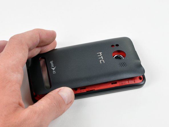

  2. HTC Evo 4G LCD Panel Replacement: step 2, image 1 of 1
    • Lift the rear panel off of the inner rear frame.

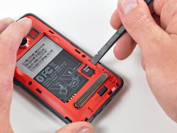

  4. HTC Evo 4G LCD Panel Replacement, MicroSD card: step 4, image 1 of 1
    • Use the flat end of a spudger to pry up the red MicroSD retainer attached to the inner frame.
    • The retainer will move about 1 mm and stop. Do not attempt to completely remove the MicroSD card retainer.
  5. HTC Evo 4G LCD Panel Replacement: step 5, image 1 of 1
    • Use a pair of tweezers to carefully pull the MicroSD card out of its slot in the inner rear frame.

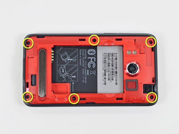

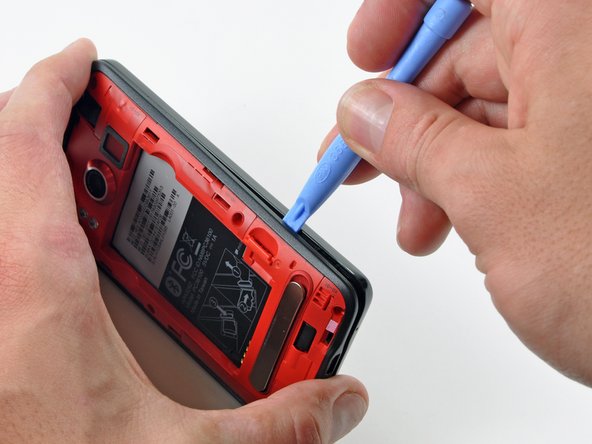

  6. HTC Evo 4G LCD Panel Replacement, Rear Inner Frame: step 6, image 1 of 1
    • Remove six T5 Torx screws securing the rear inner frame to the inner case.

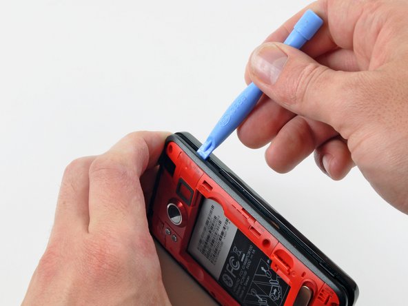

  7. HTC Evo 4G LCD Panel Replacement: step 7, image 1 of 1
    • Gently insert an iPod opening tool between the rear inner frame and its plastic surround near the Micro HDMI port.
    • Carefully pry the top edge of the rear inner frame away from the front surround of the Evo.

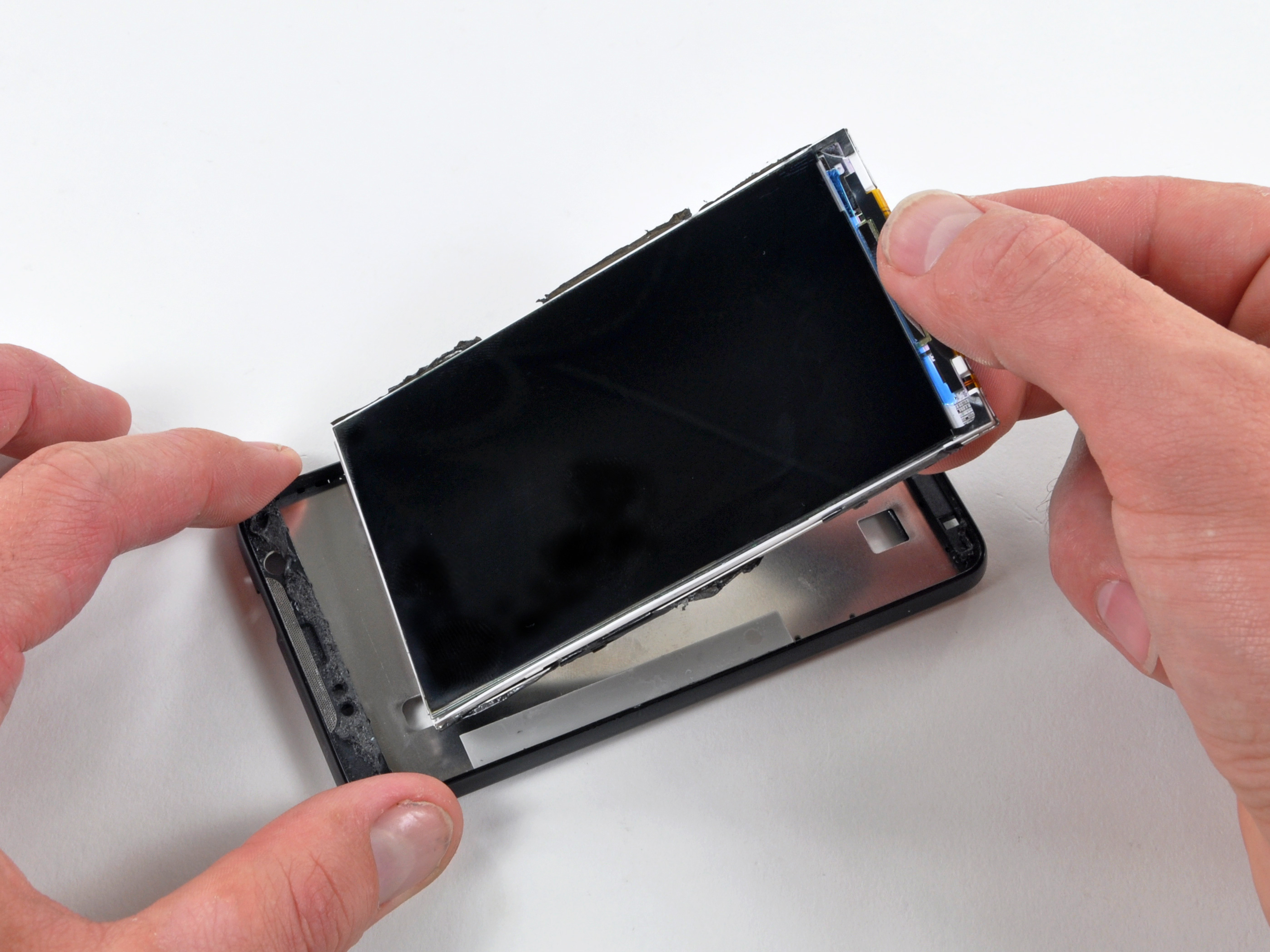

  29. HTC Evo 4G LCD Panel Replacement, LCD Panel: step 29, image 1 of 1
    • Peel the piece of tape connecting the underside of the LCD metal tray to the bottom of the inner case.
  30. HTC Evo 4G LCD Panel Replacement: step 30, image 1 of 2 HTC Evo 4G LCD Panel Replacement: step 30, image 2 of 2
    • In the following steps, you will use a heat gun to soften the adhesive securing the underside of the LCD panel to the inner case. The area the adhesive is applied to is shown in red in the second picture (with the LCD removed).
    • Use your heat gun to soften the adhesive under the LCD panel along its left edge.
  31. HTC Evo 4G LCD Panel Replacement: step 31, image 1 of 2 HTC Evo 4G LCD Panel Replacement: step 31, image 2 of 2
    • To gain enough clearance to insert an iPod opening tool, it is necessary to simultaneously push the LCD panel outwards while prying along the edges. It is recommended to push through the opening located near the bottom left corner of the Evo.
    • Insert an iPod opening tool with the edge angled up toward the underside of the display between the backlight and the metal shield beneath it.
  32. HTC Evo 4G LCD Panel Replacement: step 32, image 1 of 2 HTC Evo 4G LCD Panel Replacement: step 32, image 2 of 2
    • Gently insert an iPod opening tool between the LCD panel and its plastic surround near the top left corner of the Evo.
    • Use the iPod opening tool as a lever to pry the LCD panel away from its plastic surround.
  33. HTC Evo 4G LCD Panel Replacement: step 33, image 1 of 1
    • Use your heat gun to soften the adhesive under the LCD panel along its right edge.
  34. HTC Evo 4G LCD Panel Replacement: step 34, image 1 of 3 HTC Evo 4G LCD Panel Replacement: step 34, image 2 of 3 HTC Evo 4G LCD Panel Replacement: step 34, image 3 of 3
    • To gain enough clearance to insert an iPod opening tool along the bottom of the LCD panel, it is necessary to simultaneously push the LCD panel outwards while prying along the edges. It is recommended to push through the opening near the bottom right corner of the Evo.
    • Insert an iPod opening tool between the LCD panel and its plastic surround and pry up at several points along the right edge of the Evo.
  35. HTC Evo 4G LCD Panel Replacement: step 35, image 1 of 1
    • Lift the LCD panel assembly out of the inner case.
