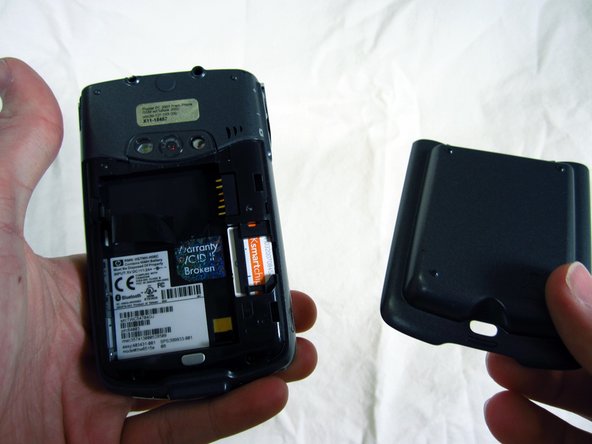

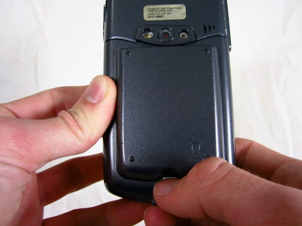

  • Flip the HP iPAQ HW6515 over with the screen facing down.
  • Take the back cover off by pressing on the small silver button while pulling back then up on the case.
  • Place the back of the case aside for now.

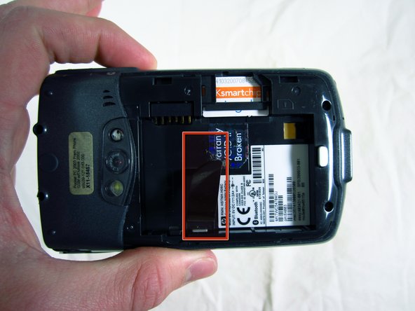

  • Remove the battery by pulling up on the black tab.

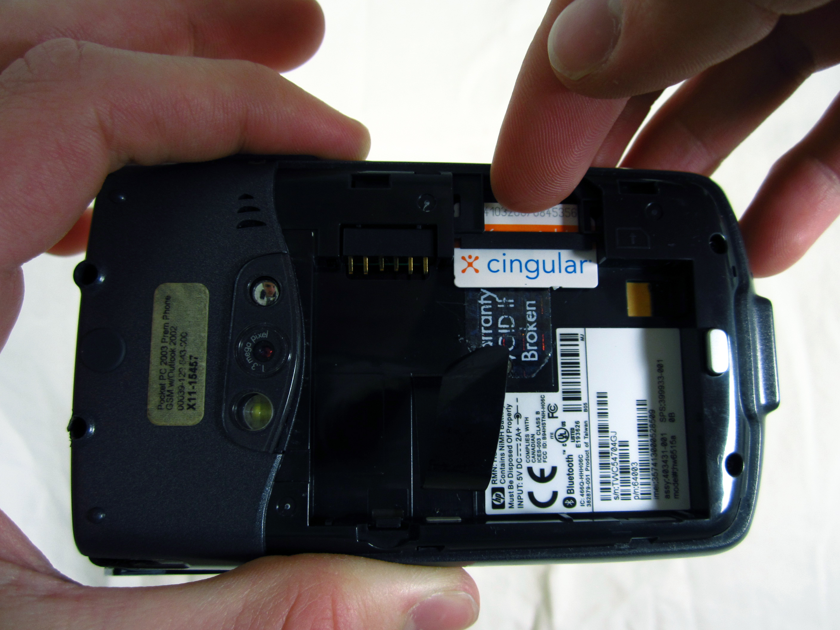

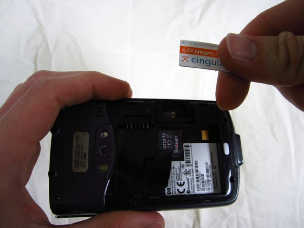

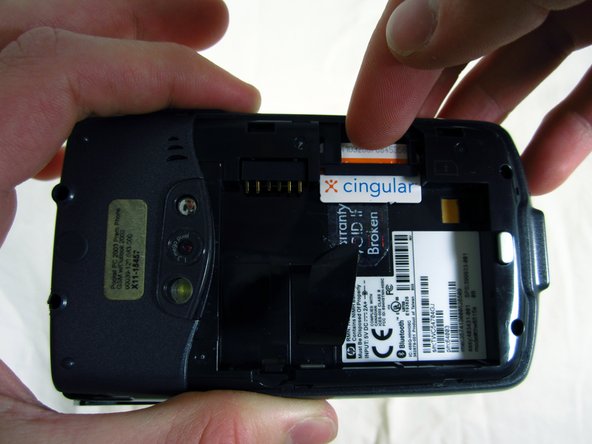

  • Place finger on top of SIM card and slide it to the left.
