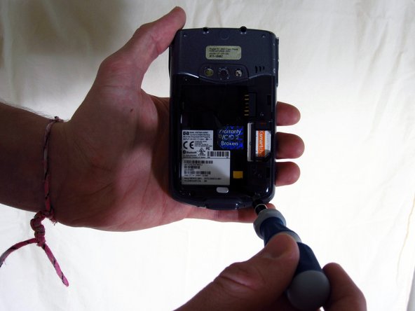

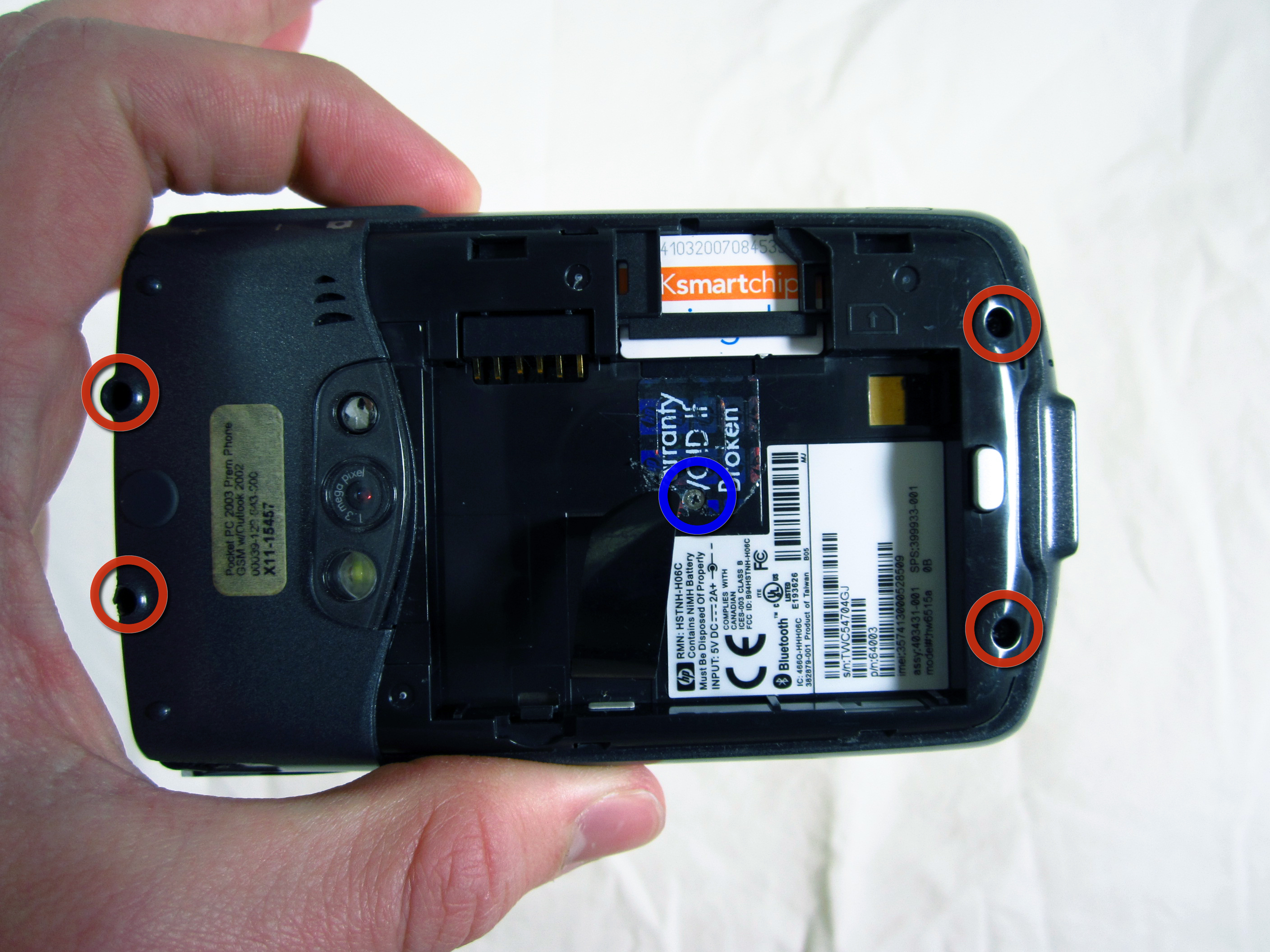

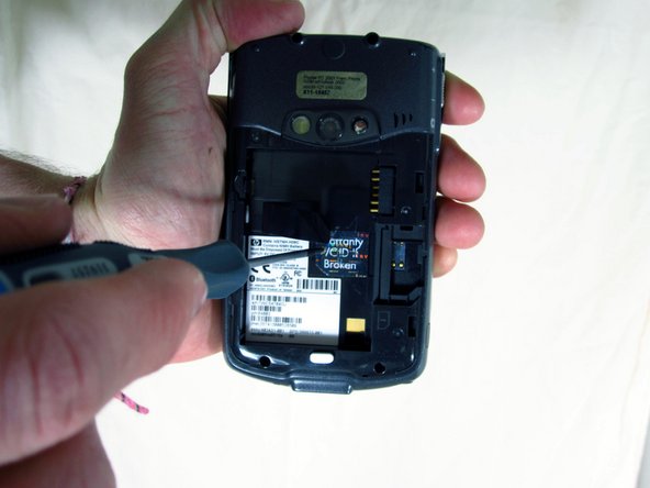

  • Unscrew the four screws using the T6 hexagonal star screwdriver.
  • Unscrew the middle screw using the Phillips 00 screwdriver.
  • "Warranty VOID if broken" sticker might be covering the middle screw, if this is the case, peel it off to reveal the screw.

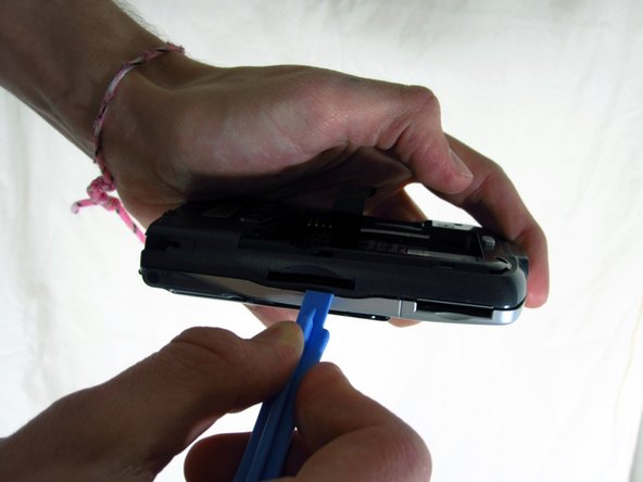

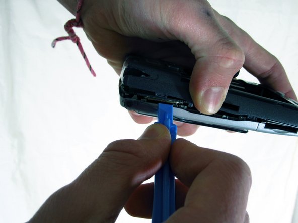

  • Use the plastic opening tool to pry apart the covers along the bottom of the phone.
  • Slide the plastic opening tool along the seam until the two halves of the case separate.

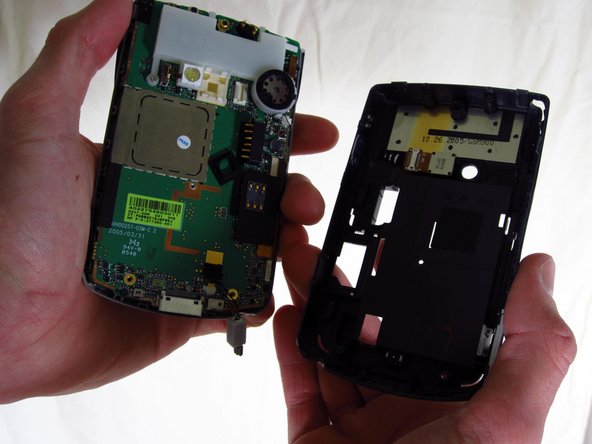

  • Unplug the sensor wire that connects the two halves of the case before pulling the two halves apart. Not doing so will damage the sensor wire.

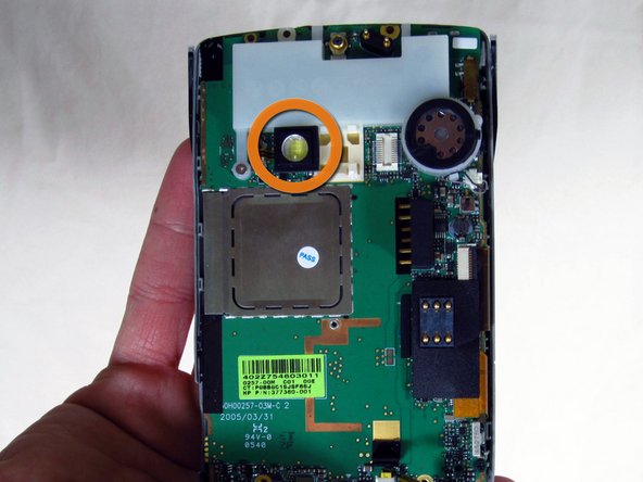

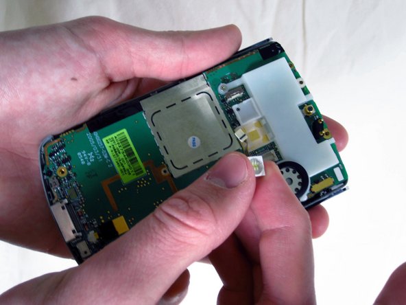

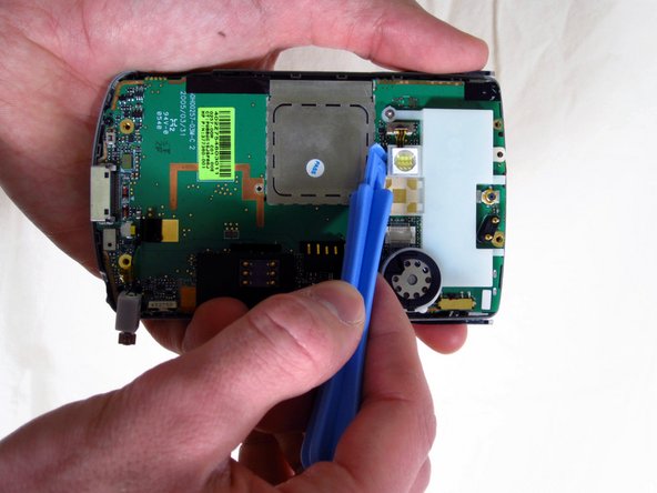

  • Gently pull off the black rubber square covering the LED light.
  • The LED is now exposed.
  • Wedge the plastic opening tool under the LED to pop it out and expose its wire.
  • Using your index finger and thumb, unplug the wire from the phone and remove the LED.
