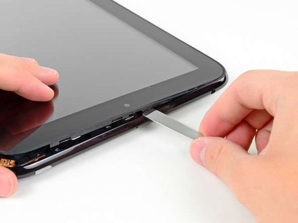

Add Note Edit Step 2  ¶
  • Insert a flat metal spudger in the gap between the rubber outer ring on the front panel assembly and the black plastic rear case near the USB connector.
  • Pry the front panel assembly up from the rear case, being careful not to damage the LCD or the glass panel.
  • As you work through the following steps, insert your metal spudger and pry the front panel up, but do not try to slide the spudger along the gap you're creating. Always remove your spudger, then insert it at another spot and pry upward.

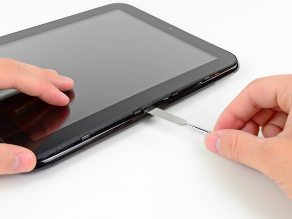

Add Note Edit Step 3  ¶
  • As in the previous step, use a spudger to pry the front panel up from the rear case along its long edge on the volume button side of the TouchPad.
  • Continue to pry the front panel assembly up along the volume button side of the TouchPad until there is a gap between it and the rear case.

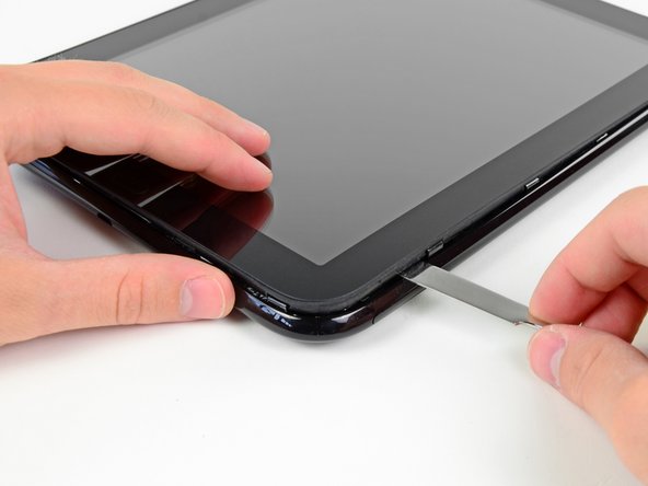

Add Note Edit Step 4  ¶
  • Pry up the front panel assembly along the top edge of the TouchPad.
  • Be careful not to damage the ambient light sensor or the upper antenna.

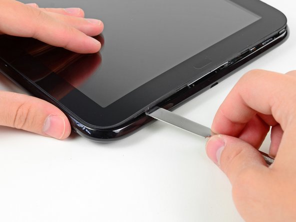

Add Note Edit Step 5  ¶
  • Pry up the front panel along the edge closest to the home screen button.

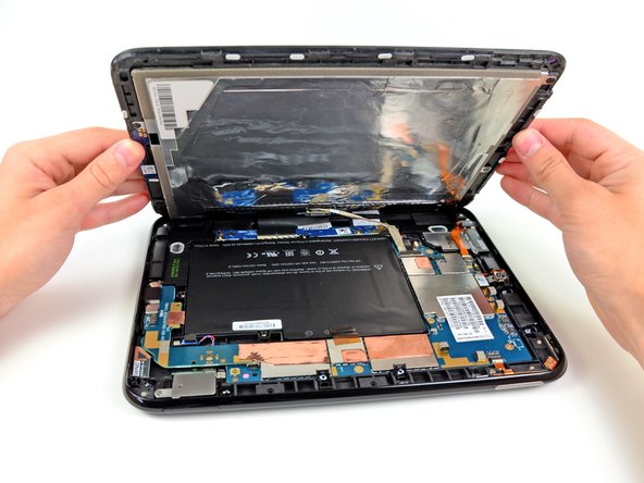

Add Note Edit Step 7  ¶
  • After freeing the retaining clips, lift the front panel assembly away from the rear case.
  • Do not try to remove the front panel assembly from the TouchPad just yet, as it is still connected to the motherboard.
Image #1

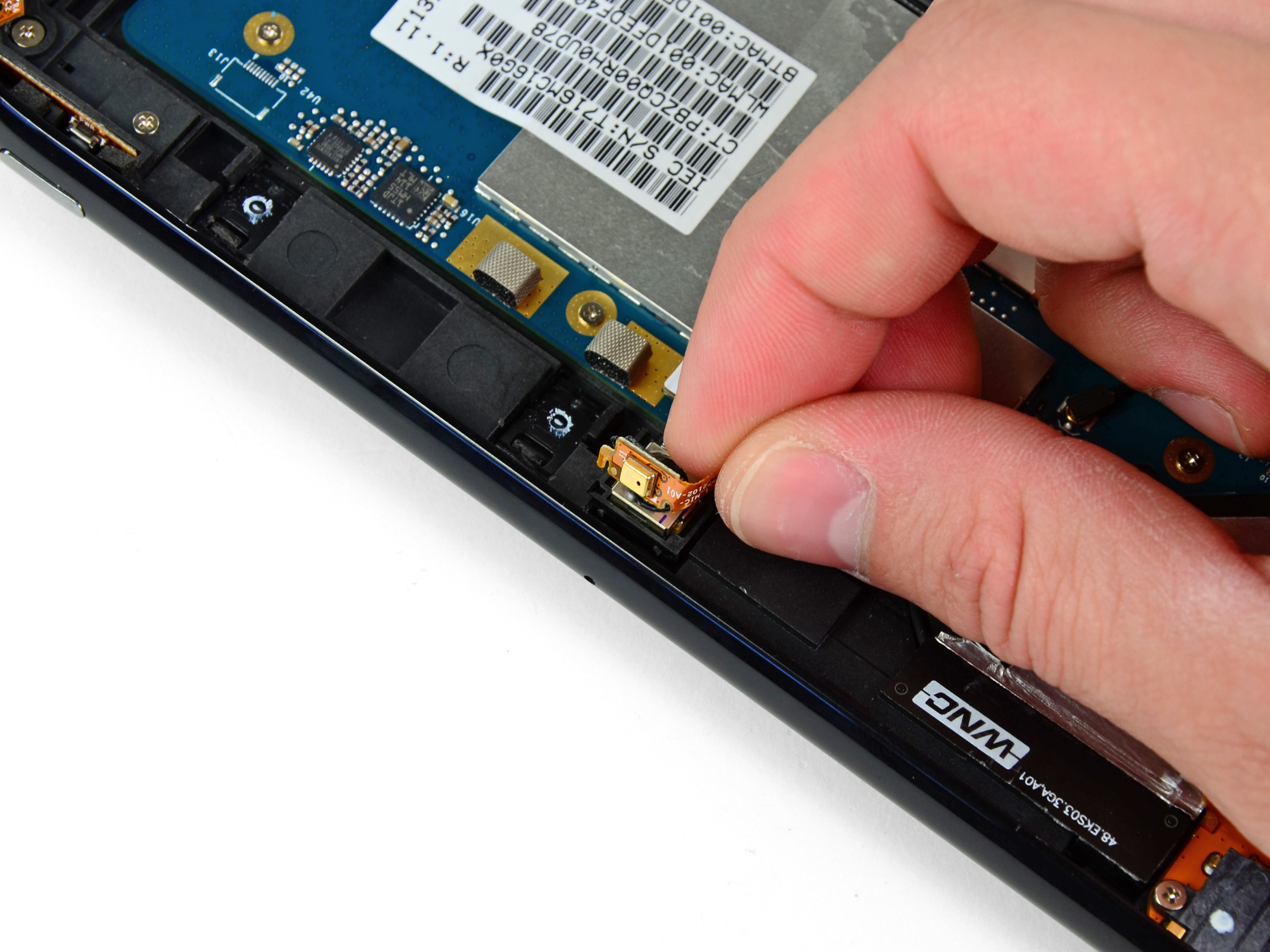

Add Note Edit Step 8  ¶
  • Use the attached black tab to pull the display data cable straight up and out of its socket on the motherboard.
  • Pull the cable upwards and not parallel to the face of the motherboard. Doing otherwise may damage the socket on the motherboard.
  • Take care not to pull on the ribbon that is stuck by adhesive to the bottom of cable you are detaching. It does not need to be disconnected.
